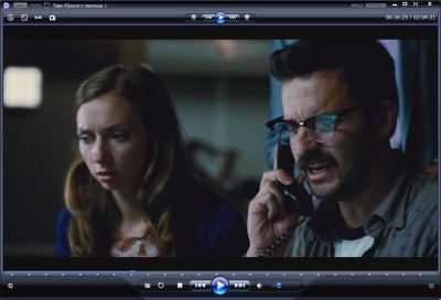

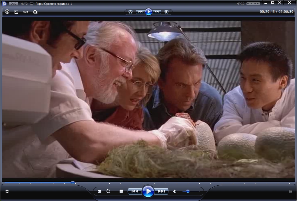

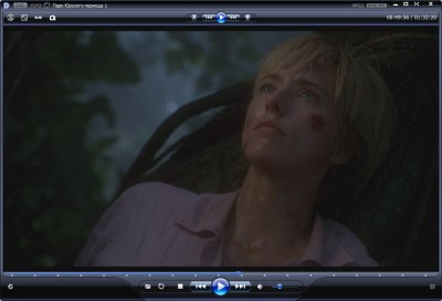

Here is an examples of may experiments. I always use SP-mode, 2-pass, bq-option and lanczos filter. Ofcourse there's some blocks in fast movement in several scenes but it's not very critical.
I must say that late 7.0.38 version is quite good. Provides better quality with low bps. It's a bad way to think that auto mode will bring you better quality instead of SP-mode.

is these screenshots quality good?igor_lvk wrote:I don't think you've got pixelated scenes because of low bps. Maybe it's all in upsacaling method of your TV.videodude333 wrote:Are you using 4.7GB divs or 8.5GB discs? Usally 2 movies is a max for me per disc (4.7GB) but I have noticed on the hd 1080p tvs the darker scenes go all pixeleated due to CXD using very low bitrate on these parts. This doesnt happen with AVS2DVD programme but I wonder will a 8.5GB disc fix this and allow CXD more space to play with when applying the bitrate throughout the conversion.No, man. I got exellent quality with these settings. I easy put up to 4 movies on 4.7Gb disk.
Re: CXD Conversions Look Pixelated with Low Bitrate???????
You think that it's bad???is these screenshots quality good?
- VSO Fanatic
- Posts: 615
- Joined: Wed Mar 04, 2009 11:28 pm
it depends on your source, but screenshots quality is not goodigor_lvk wrote:You think that it's bad???is these screenshots quality good?
Ofcourse it depends of the source, but on old TV 4x3 it looks very good.deadlyshadow wrote:it depends on your source, but screenshots quality is not goodigor_lvk wrote:You think that it's bad???is these screenshots quality good?
