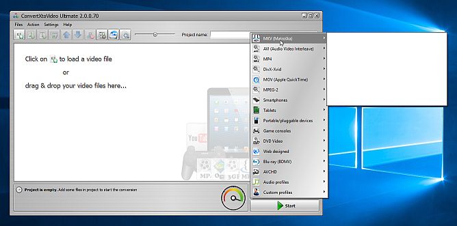

Not sure if its related but when i was selecting profiles the menu selection cleared so you could not read them (i will try and post a screenshot of it)

PS screenshot of profile selection I mentioned in the previous post

I still have menu options appearing blank, and other odd things with the interface, like the quality factor being way off (default appear to be set to high or something unless one changes it to something else then back to default)
