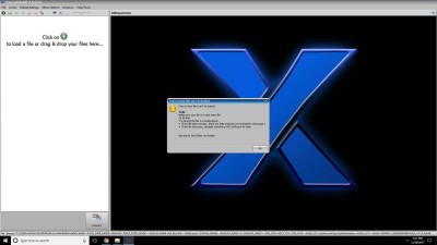

Hi guys converter x to hd is not recognizing a blu ray folder structure even though it does normally. Log provided below

Not recognizing blu ray folder structure
- ConvertXtoHD 3_crashlog.20171230.154902.289.log
- (3.61 KiB) Downloaded 430 times
