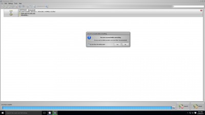

Also after it fails it comes up with Not Enough storage is available to process this command but i have heaps of room on my hard drive

So just to confirm i think we need better compatibility to do Raw copies of file to blu ray folder structure and avchd as this would save hours of PC time.
And here is a pic of the error that comes up
