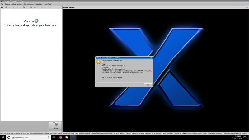

Hi guys converter x to hd is not recognizing a blu ray folder structure even though it does normally. Log provided below

ConvertXtoHD 3_crashlog.20171230.154902.289.log
(3.61 KiB) Downloaded 535 times

I am getting sound but no picture when converting this file in remux mode all other file work fine just not this one. This happens when i play it in my blu ray disk recorder

The excerpt you attached corresponds to just a ts of a little over a minute, is there any other stream in the folders?
jmanwf
Posts: 145
Re: Not recognizing blu ray folder structure
Post by jmanwf »
Nope just used that as a test clip
felicia
Posts: 599
Post by felicia »
A single clip is not a BD, and with that short duration it could be anything in the stream, please test with full a BD.
