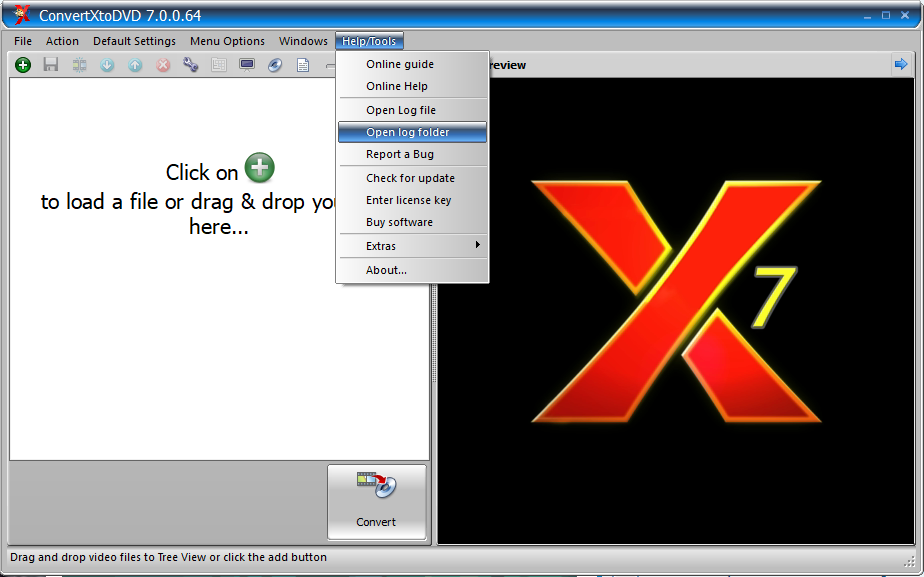

If you tell me how to post Conversion log's I will post them.
JJ wrote:It is impossible to fix something that can not be reproduced, and as this is not happening to everyone, those who have been affected they should post conversion logs for inspection.
Re: "Working folder not accessible"
Here you can open folder where logs are.
