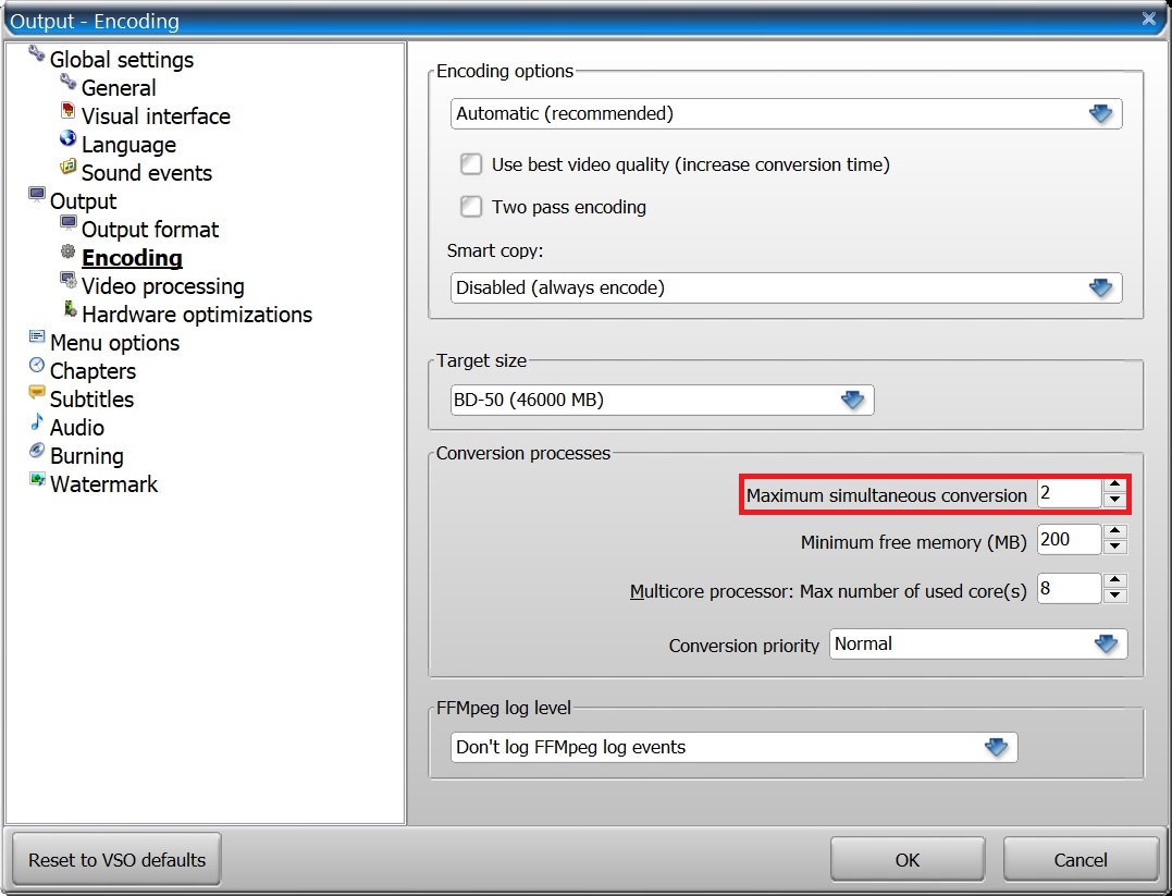

Re: 2 NVIDIA Graphic Cards
Made a mistake with the screenshot and number of instances.
What I would like to know: Must I set 'Maximum Simultaneous Conversion' to 4 (2 cards) or must it stay at 2?
Have attached to correct screenshot.
My appologies for the inconvience.
Nemesh

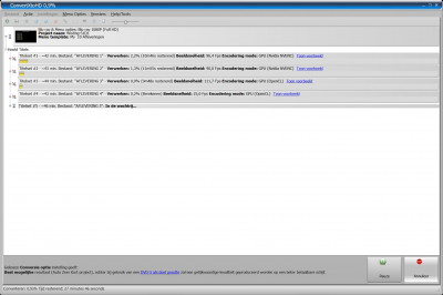

Today I received the second GTX 1650.
Remember Maggie, I told you that the GTX 1650 cards are NOT SLI.
Build it in to my computer, and started a prject for conversion using NVENC.

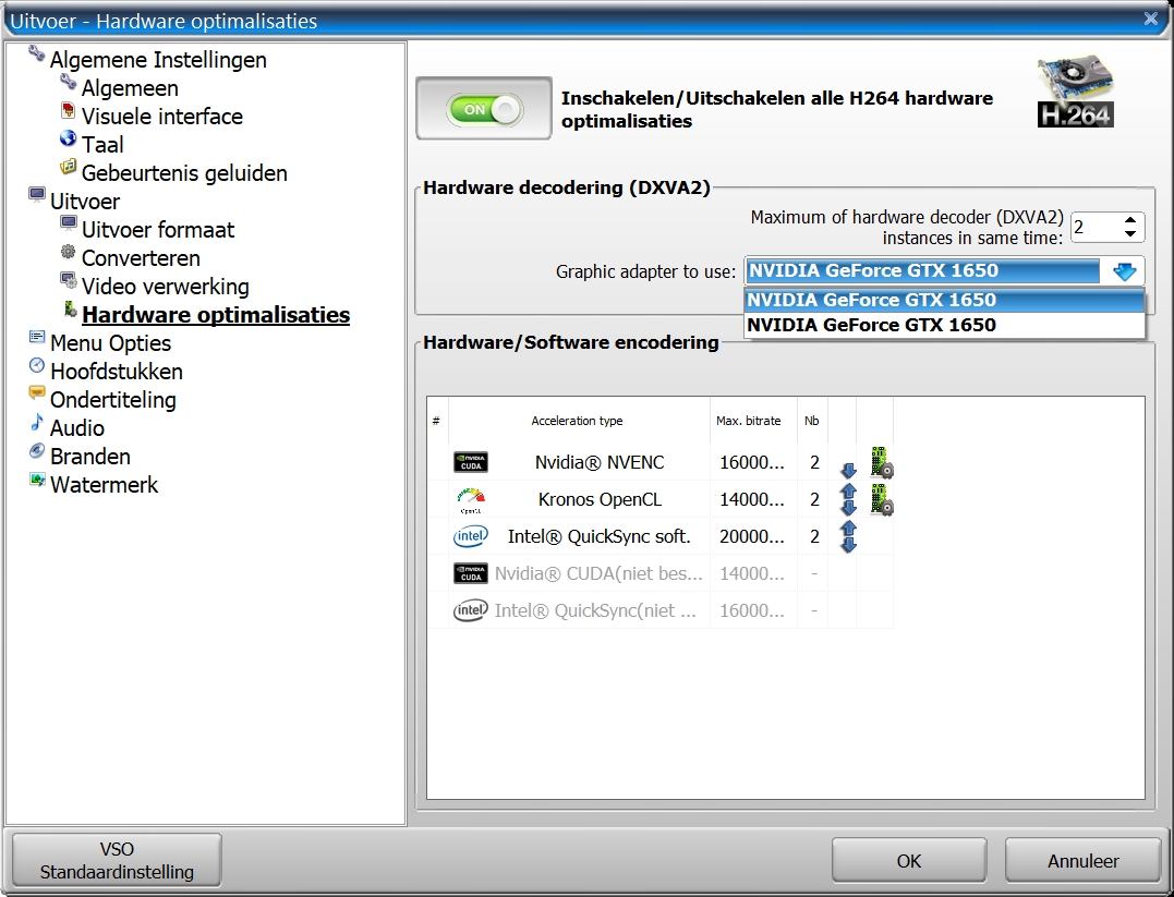

ConvertXtoHD sees both graphic-cars: see screesnhot1
Set the Maximum Simultanious Conversions to 4.

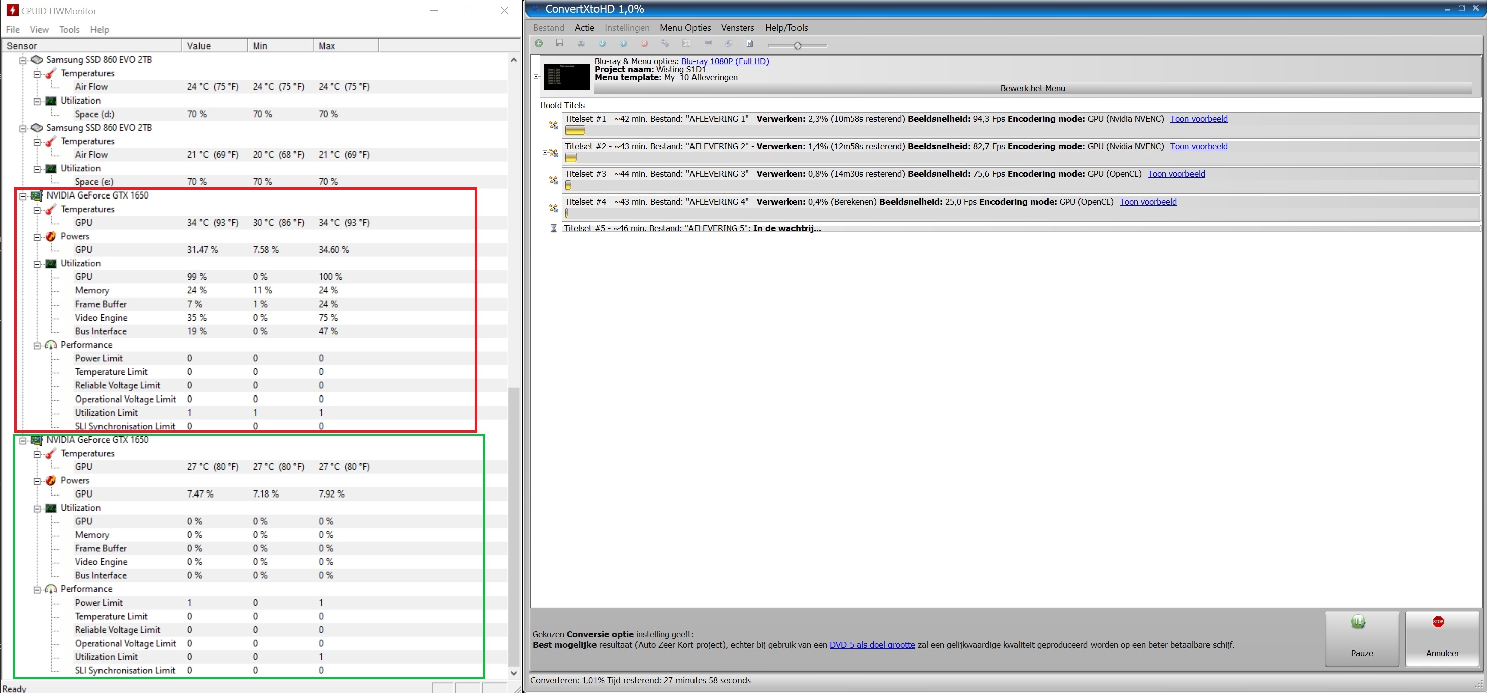

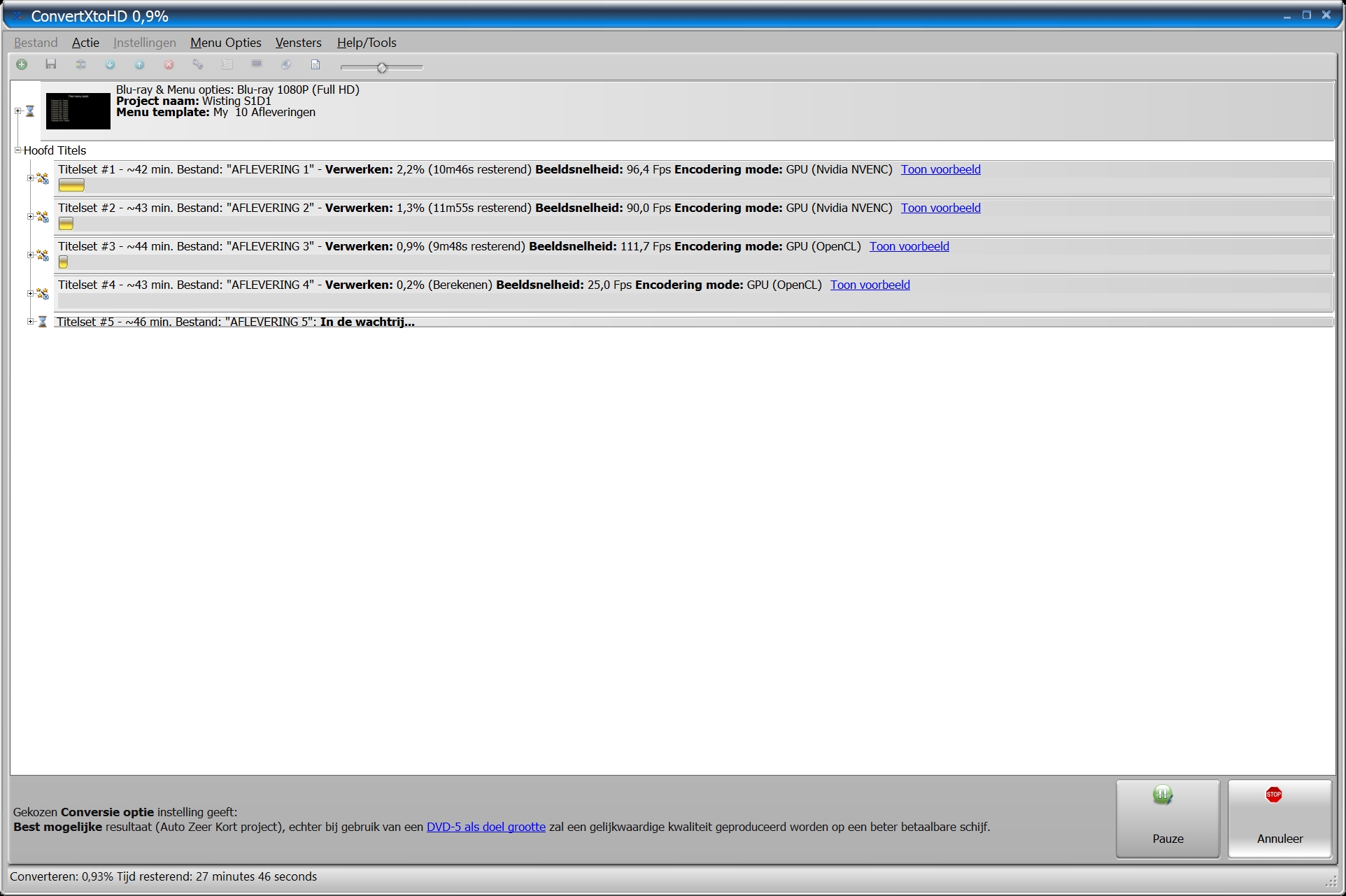

But then ConvertXtoHD uses 2x NVENC and 2 GPU OpenCL and NOT 4x NVENC: see screenshot 2.
With Maximum Simultanious Conversions set to 2 there is no increase in conversion-speed.
To see what was happening I also started CPUID HW Moinitor 1.41
Then also started a project with ConvertXtoHD
As you see in the screenshot only 1 card is used (red square).
The other video-card (green square) is not used.
Not matter what card I select or setting simultanois conversions, ConvertXtoHD uses only one card.
Please take a look at screenshot 3.
Am I doing something wrong?
Must I do a diffrend setting or is this a bug?

Decoding: only one card will be used for decoding (the preferred) ---- at its full potential.
Encoding: TWO CARDS (max) can be used simultaneously HOWEVER they have to be from different brands.
(ex1: one Nvidia and one ATI -> they can work simultaneously at their full potential)
(ex2: old Nvidia, new Nvidia -> only the preferred one will be used at its full potential)
Potential of Nvidia cards: https://developer.nvidia.com/video-enco ... ort-matrix
"Max # of concurrent sessions" -> number of encoders (simultaneous) for this card
"Total number of NDEC" -> number of decoders (simultaneous) for this card
Cheers,
Cheers,
