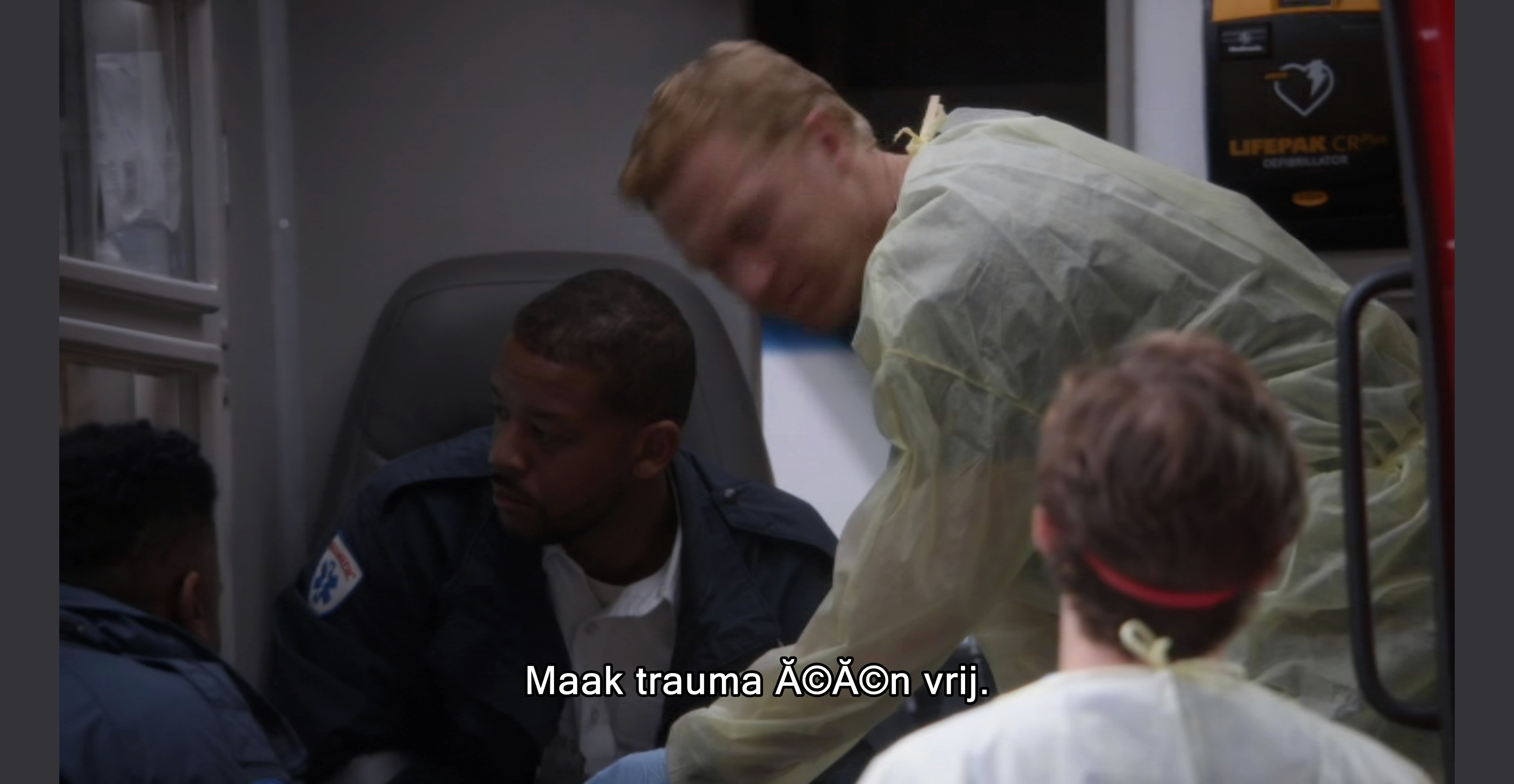

ConvertxToDVD converts the several subtitle-character wrong.
Screenshot 1 should bw: één
Screenshot 3 should be: patiënt
Screenshot 4 should eb: gênant
Working from srt file.
Font selected Arial, see screenshot 2
Using ConvertXtoDVD vserion 7.0.0.69
And there maybe more characters.

Re: Wrong Character Conversion
Post by Nemesh »
Solved the issue.
Default Settings -> Subtitles -> Subtitle Rendering Settings: Code Page set to ASCII
The examples above are gone.
Tested also with ñ and some other letters but now it seems fine.
Much regards,
Nemesh
Post by Jacques (VSO) »
If the SRT (or in fact any text-based subtitle files) is specifically converted to UTF-8 format (unicode), then it'll work as UTF-8 is the default code page.
But if the subtitle file isn't unicode, then it may be incorrectly rendered, in that case, it must be set specifically in the subtitle settings to operate.
the most simple to be sure is to use a text editor (such as notepad++) to convert the subtitle file to unicode (UTF-8) format with BOM. With such a file, it'll always work.

Post by Nemesh »
Hello Jaques,
I have set UTF-8 with BOM in Subtitle Edit.
But had to set it from Western European to ASCII in ConvertXtoDVD.
Much regards,
Nemesh
