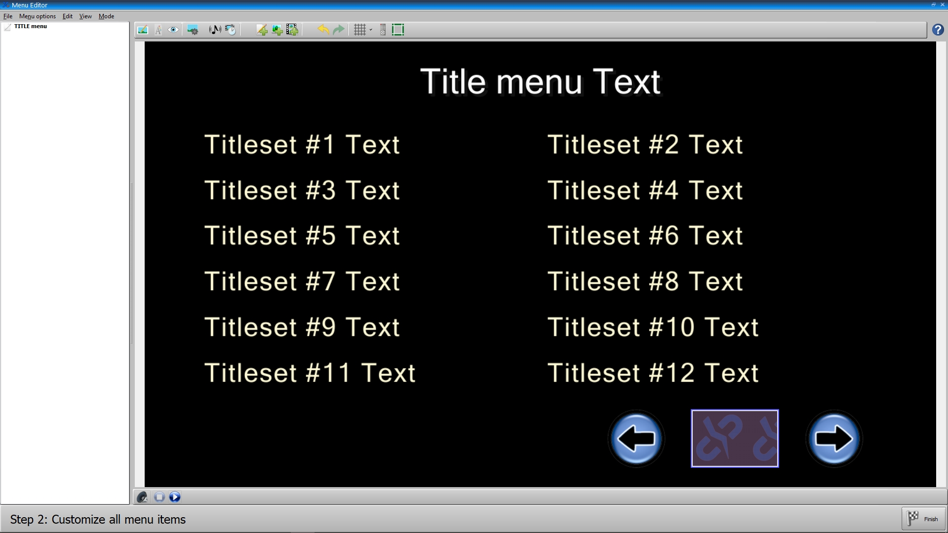

Menu is created with the 'General Purpose Open Style, see Screenshots 1/2 & 3
The menu has 2 pages because each disc has 12 episodes.

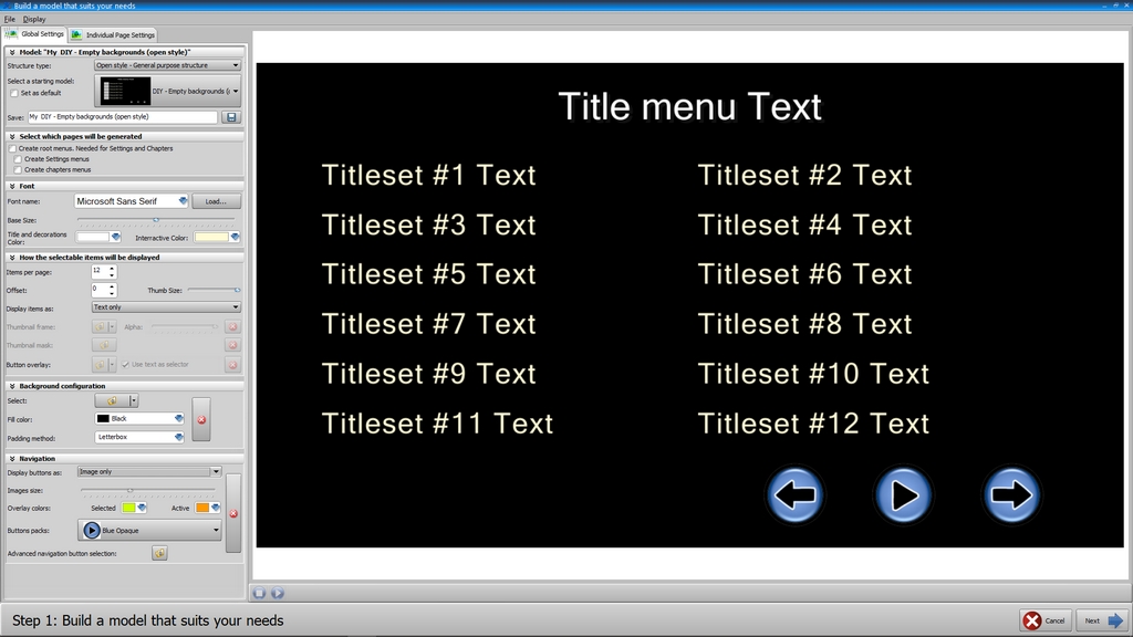

Removed from the menu the 'play' button and only have the the two arrows 'to go to
the next page' and the 'go back to previous page' arrow.

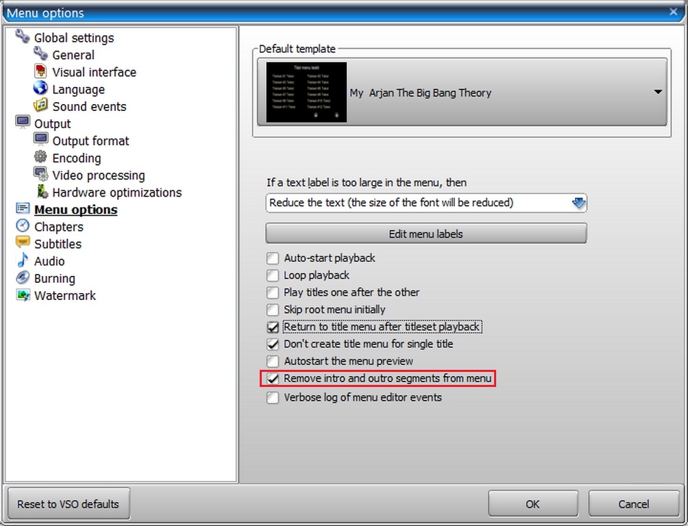

Disabled this by selecting in the menu 'Remove intro and outro segments from menu (see Screenshot 4).
This did 'the trick' when I selected a episode the player started to play the episode right away.

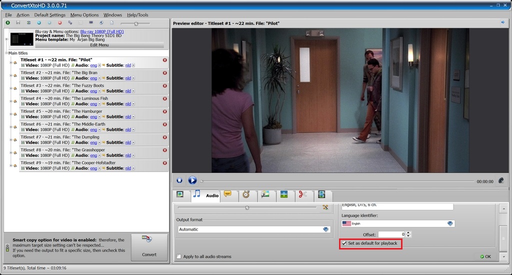

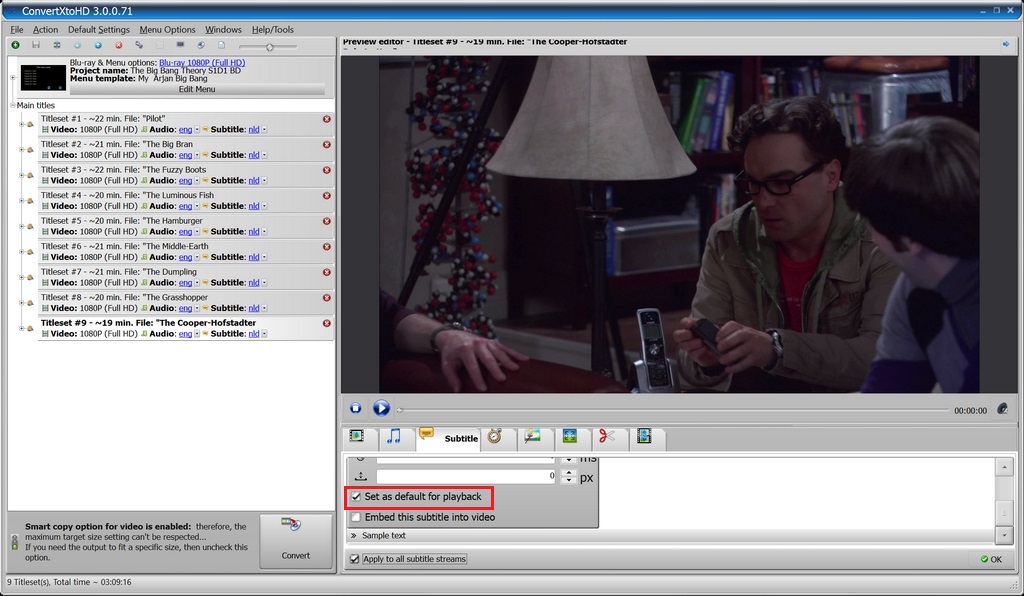

Have only the English audio and 1 subtitle (in my case Dutch)
Both are set 'On' after I have added them in ConvertXtoHD:
English Audio,see Screenshot 5
Dutch Subtitle see Screenshot 6

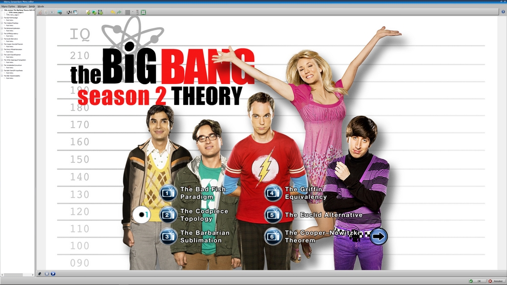

Then this is the end result:
Menu Page 1 see Screenshot 7
Menu Page 2 see Screesnhot 8
