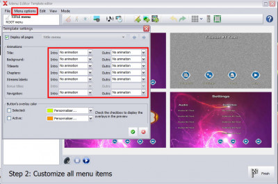

You can produce a menu template with the menu animations altered or removed compleatly, using the template editor.

The image shows step 2 of the template editor.

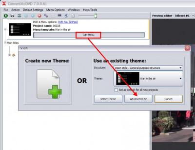

Yes you can.
Check the following settings:
Get to Advanced Edit as in the first picture.

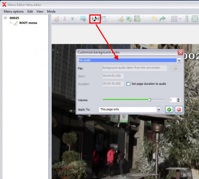

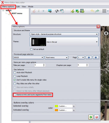

Go to Menu Options to do any required adjustments, as in the second picture.
You can remove the intro and outro animations on the menu pages.

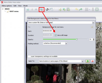

Use the settings as in the third and fourth pictures to apply a still image from the movie as the background. Or use an external image.
Remove the audio or use an external audio file.
Experimenting with these settings should help you get the result you want.

Thanks! Those settings look like precisely what I needed. I failed to see the Still Image check box.

I discovered what was preventing me from doing it, but it may be a bug, or, at least, undesired behavior.
I always change the default Menu Options setting for Don't create title menu for single title. I always uncheck this option because even if I only have 1 title, I want the main menu to always load up first when the DVD starts.
Anyway, with that option unchecked, the Duration options, including the Use still image, are not selectable. But, is this a bug? Shouldn't the option still be available for those who want to change it on single title DVD's? If it's not a bug, is it undesired behavior, counterintuitive to logic?
