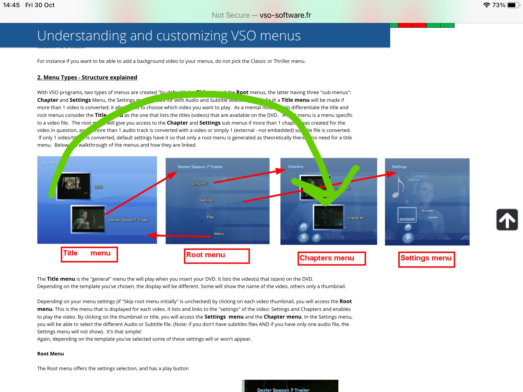

Post by ArthurDent2020 »
Hello
Still looking for a solution....
I have added several video tracks and merged them as Title 1
Then I added some more tracks and merged them as Title 2
I renamed Titles 1 & 2
I choose VSO glossy with 10 items per page, but when I select Simulation and click on one of the Titles it goes straight to the first Chapter ( Video track ) I want it to go the the Chapter pages.....so how do I achieve this please ?
