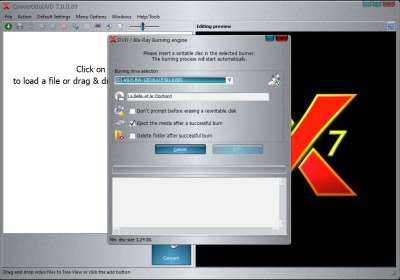

Normally if you use "burn as already converted project" option you have directly the burning window (as on the screenshot below).
But in your case I imagine your files open in the main window at the left?

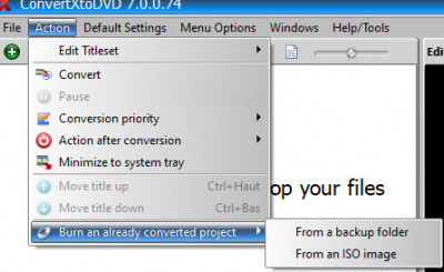

Go here. Only works if you have not set option to delete files on completion
Re: How to burn already converted files without having to convert again
This can be used with any folder containing Video_TS, you can copy from existing DVD whole folder to computer and then from CXD select this folder to burn.
