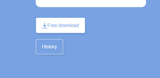

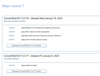

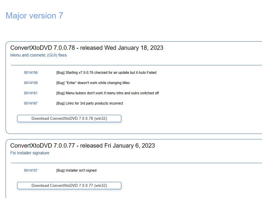

vers 7 had a bug stopping update to 8.
To find latest version 8, go to the app page, and click on history.
See pics
