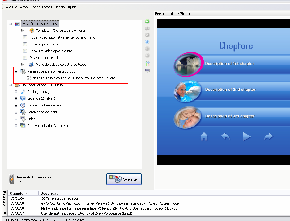

I really need help! I wanna put an image on my menu but I don't have the BACKGROUND VIDEO TOOL.
Please I really don't know why I don't have the tool!
Posts: 5605
Not every template accepts an image as the background.
You are using the Default, Simple Menu.
This one doesn't accept a custom video/image as the background.

Hey thanks for the info in this thread, think I've finally got it. One question: what effect does changing the background in the "Text style editor" have? Is this only for changing text style of menus etc (ie. the background chosen does not appear in the Menu)?
Posts: 5605
Well right now, seems the Title Settings is hardcoded in the template.
So changing the style, font, color will do nothing.
Maybe it will change in the future, but seems to be like that.
Now for subtitles, the affects doesn't change either, but it seems this is a bug.
So let's see what the next build will give us !
