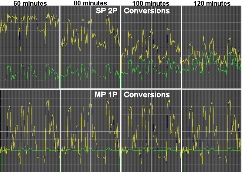

Fig. 2 shows how project length affects conversions. Both bitrate and Q are shown there with the vertical scale for Q varying from 0 to 10. Remember that Q (shown in green color) can be taken as a measure of quality with lower values indicating better quality.
Note that the plots for MP 1P are all the same because none of those conversions fill the DVD. The Q plots in them are not exactly constant, there are small peaks at the most complex scenes so CX2D has not done a pure CQ conversion. It cannot because DVD standards impose a maximum bitrate that can be used on a DVD that standalone players can be designed to play correctly. We still refer to conversions of that type as CQ though even though they are not pure CQ.
(A pure CQ encode would require trial and error conversions to find the minimum Q that would not cause bitrate to exceed the max allowed and would not exceed the size of the DVD. That would normally require a higher Q than used by CX2D which would cause overall quality to be less than with CX2D’s modified method.)
Now look at the plots for SP 2P at 60 minutes. That conversion did not fill the DVD either so it is a CQ conversion in the same manner, although not as apparent because it uses a lower Q value of 1 and Q has to rise to the same levels as for MP 1P for the complex scenes.
(Higher values of Q indicate that more bitrate was needed to maintain constant Q but could not be applied.)
We can compare bitrate and Q directly here because the same encoder was used for all conversions. Extensive analysis of converted results confirms this.
So, at 60 minutes, the SP 2P conversion is clearly better than one with MP 1P in simple scenes, but there is little, if any, difference in complex ones. But look at what happens with longer projects where SP 2P fills the DVD and an average bitrate must be imposed to force converted size to fit the DVD. Q begins to rise for all scenes as project length increases. For 120 minute conversions, it is about 45% higher for SP 2P than MP 1P in complex scenes and only about 12 % lower in simple ones. So one would expect MP 1P to give better quality overall at 120 minutes, and thorough examination of frame captures combined with careful viewing of playback confirms that.
One must conclude then that the best choice of encoding options for a particular source depends on project length. Note that converted size also depends on project length and the choice of encoding option
These plots show the progression from a CQ encode to VBR for SP 2P as project length increases. Since the overall quality of those encodes, compared with MP 1P, drops for longer projects, one must also conclude that using SP 2P for most projects, as proposed by some users, is not wise.

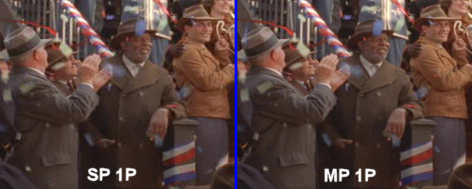

Fig. 4 and 5 present worst case partial frame captures to help you decide. Remember that a frame capture represents what is actually converted and written on your DVD for every pixel, it is not enhanced as usually done when playing the conversion on your computer with a software player or when played on your TV through a standalone player.
Download those figures, load them in a viewer or graphics editor and zoom them to about 300 % where individual pixels are apparent to see differences better.
You should find big differences for complex scenes and less of a difference in simple ones. Those images also give a clue about how the different encoding options work.
Look for differences in sharpness of detail in the complex scene in faces, clothing and the colored tape around the stair rail and the post. You will find what appears to be the beginning of block type pixilation with SP 1P in areas where there is little variation in visual properties like the man‘s gray pants or the coats and hats. It really isn’t as bad as it may seem at first glance. In an editor that has a tool that shows visual properties for individual pixels, you will find that those properties actually vary within what appears to be a block of equal properties, the biggest block I found, in a quick examination, with the exact same properties is 3 x 3 pixels. So the encoder has done the best it can do under the circumstances but the result is not good when viewed during playback.
There may be little difference at first glance in the simple scene comparison. But a close look at things like the texture of wall paint, edges of the vertical post and individual strands of hair shows a little less detail for MP 1P, but the face, the most important part of the scene for most people, is fine unless one is very critical. The result can best be described as a softening of the scene. Many people that have no experience with video conversion and therefore no prejudices or biases either don’t notice a difference during playback or, believe it or not, actually prefer the softer look of the MP 1P conversion for simple scenes.
Note again that Fig. 4 and 5 represent worst cases, they are for the specific encoding options and projects shown in the titles. But they can be used to get an idea of what to expect in other cases, refer to the discussion above of Fig 2 and 3 to get an idea of what can happen.
MP 1P should be the clear winner here if one keeps an open mind. So a CQ conversion that did not fill a DVD is better than a non-CQ VBR conversion that did fill the DVD, at least in this case. The same will be true in most cases as shown by many tests discussed in the References below and opinions of unbiased people watching conversions.
And, because the only noticeable difference between SP 1P and MP 1P when both do not fill the DVD, is a slight reduction in quality with MP 1P in simple scenes which many do not object to or even like better, one can conclude that not much is lost, if any, if the MP option is chosen when in doubt about whether SP will fill the DVD or not.

What is going on? There is little difference in the simple scene of Fig. 5, SP 1P looks only slightly better despite applying more than 4 times as much bitrate as MP 1P. But there are big differences in the complex scene of Fig. 4. MP 1P is much better there even though it applied only a little more than 2 times as much bitrate.
That points to the conclusion that quality in a CQ encode is not determined by bitrate alone, and therefore bigger converted size does not guarantee quality. One might also conclude that the SP option applies more bitrate to simple scenes than is necessary if you agree that MP does a pretty good job.
