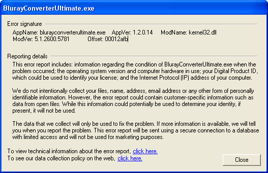

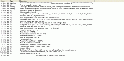

Hello.
I'm interested in this so i checked out the trial version.
I keep getting this error when trying to convert the bluray. [see log below]

I"ve tried loading from my blu-ray disc and also from a blu-ray folder[ripped using AnyDVD HD] but with same error message.

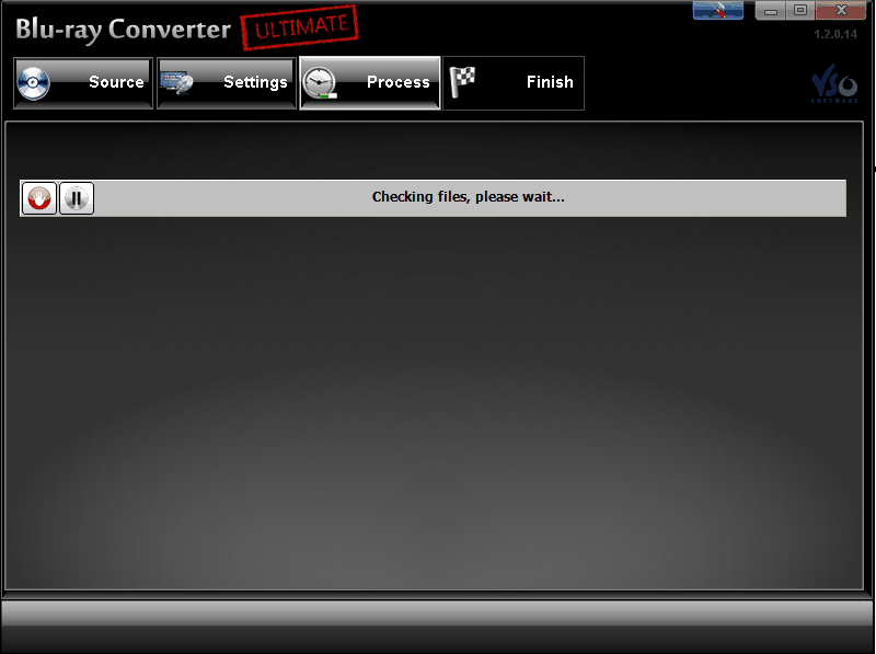

I've also tried various settings but either the result is as in the log file, OR Blu-Ray Converter Ultimate just shows "Checking files, please wait..." forever until i have to cancel the conversion process.
Any ideas? :)
