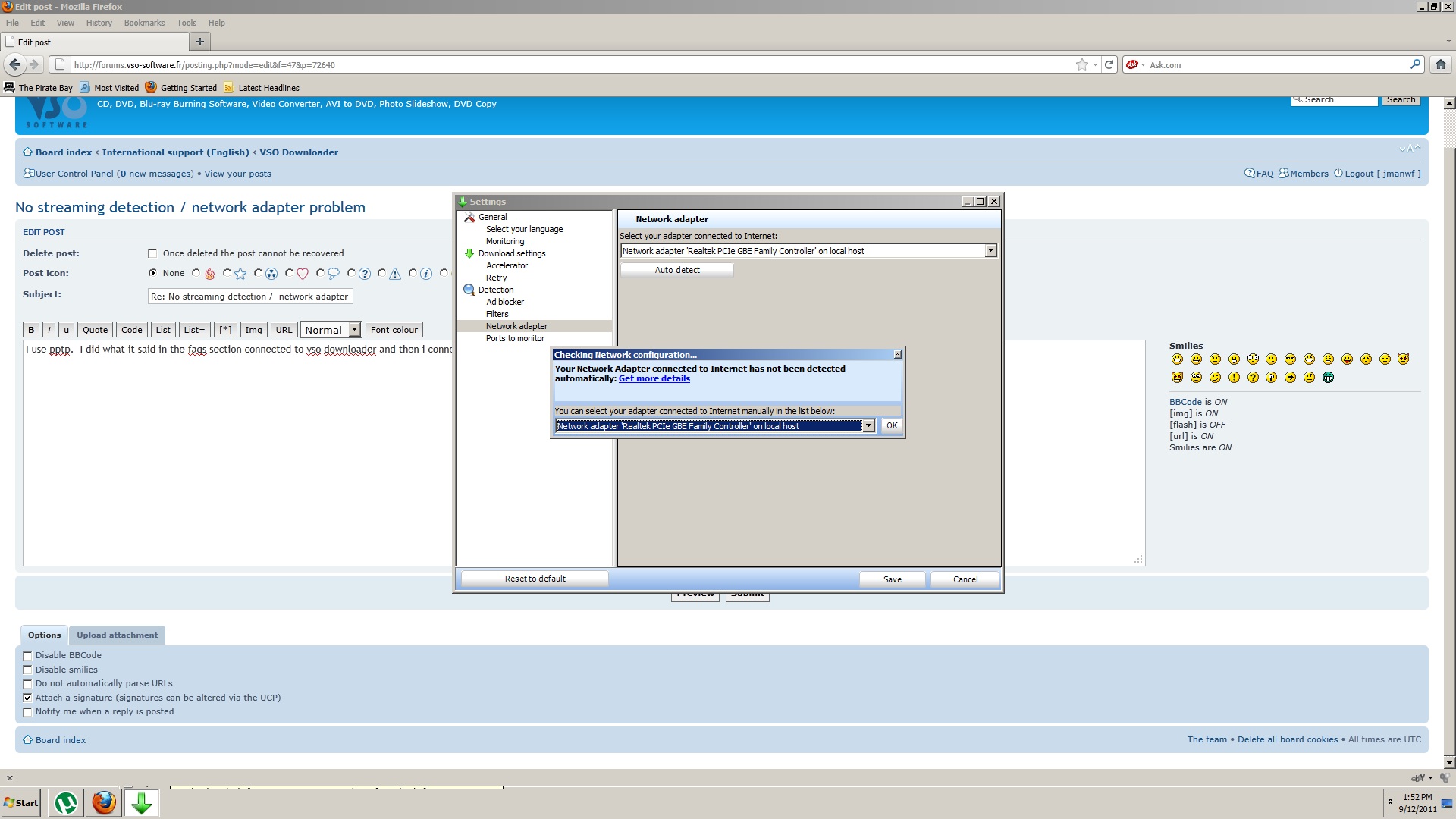

Hi clair i have a vpn and a realtek pcie family controller connection and a vpn provide but it isn't detecting my vpn and when i use my vpn i cant download videos

what kind of VPN do you use: Open VPN or PPTP?
does your VPN have a proxy?

I use pptp. I did what it said in the faqs section connected to vso downloader and then i connected to my vpn provider and then tried auto detect but it didn't detect it MY VPN PROVIDER IS vpn authority. but it didn't detect maybe this is a glitch in the program at the moment. I have upload a screen shot of the error

1) install the latest version
2) Disconnect your VPN then go to option > Detection > Network adapter > Auto detect adapter: is it found without any problem?
3) copy your log file (help > open log file) in this thread

Hers my log:
2011-09-17 15:06:44 Info Streaming monitoring enabled
2011-09-17 15:06:44 Info Settings applied
2011-09-17 15:06:08 Info Network adapter successfully detected automatically: Network adapter 'Realtek PCIe GBE Family Controller' on local host
2011-09-17 15:06:08 Info Network adapter 'Realtek PCIe GBE Family Controller' on local host: <b>Online</b>
2011-09-17 15:05:58 Info Streaming monitoring enabled
2011-09-17 15:05:45 Info Previous download successfully loaded: 0
2011-09-17 15:05:45 Info Streaming monitoring enabled
2011-09-17 15:05:45 Info Winpcap is installed: WinPcap version 4.1.2 (packet.dll version 4.1.0.2001), based on libpcap version 1.0 branch 1_0_rel0b (20091008)
2011-09-17 15:05:45 Info Streaming monitoring disabled
2011-09-17 15:05:45 Info Settings applied
2011-09-17 15:05:45 Info VSO Downloader: Version 1.3.0.33
2011-09-17 15:05:45 Info Winsock: Version 2.2 - WinSock 2.0 Running
2011-09-17 15:05:44 Info Settings succefully loaded
2011-09-17 15:05:44 Info System default language : English (United States)
2011-09-17 15:05:44 Info User default language : English (United States)
2011-09-17 15:05:44 Info Version : 1.3.0.33
2011-09-17 15:05:44 Info ExeName : C:\Program Files (x86)\VSO\VSO Downloader\1\VsoDownloader.exe
2011-09-17 15:05:44 Info OS : Microsoft Windows 7 Ultimate (Build 7601: Service Pack 1)
2011-09-17 15:05:44 ---- ******************** Log session start 2011-09-17 15:05:44.415 PID 3116********************
And here is my vpn log info for you as well Operating System : Windows NT 6.1 Service Pack 1

It dosent seem to be detecting vpn authority
Posts: 6343
Re: No streaming detection / network adapter problem
According to this - capturing VPN is not possible with this version of windows.
