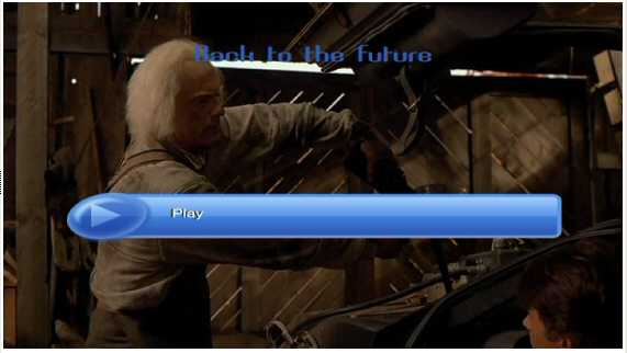

All the “Glossy” template types enable to add video and audio.

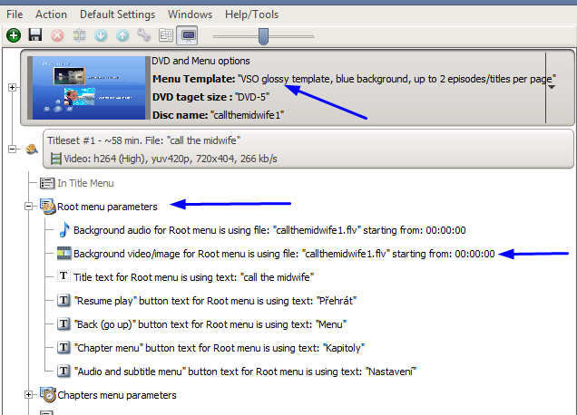

To cutomize the background of the ROOT menu:
1. Select right menu type as indicated above
2. In the treeview, underneath your titleset, click on "Root menu parameters" and click on "background video/image for root menu..."

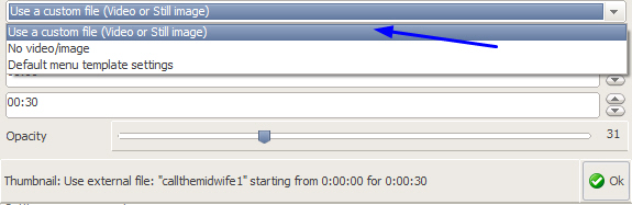

This opens a window where you need to click on "use a custom file". A browser will open where you will be able to search and load your video/image. Since you’ll certainly want to add the video that is in your project, you still need to select it there.
If you load a video that has an audio, you will be asked if you want to keep the audio (except for CX8 titles and Simple backgrounds who do not allow audio). If you do, it will be played with the video in the background of the menu

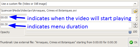

You can also decide not to play the video from the beginning (so you can select a specific scene from the video or if the movie starts with credits or an intro and you don't want this to be in the background). In Starting time indicate the start time where the video should be played from.
By default the Menu duration is set to 30 seconds but you can change that duration. If your video or audio file is not as long as the menu duration set, it will loop.
You can have the background video or image appear with more or less opacity if needed, depending which you can edit thanks to the "opacity slider". Click on "OK" and you will see the result live in the preview on the right, just click on the "play" icon.

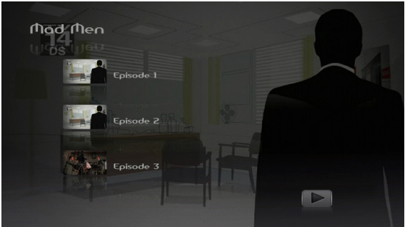

2. Projects with more than one video.
If you only have one video in your project then you will need to customize the TITLE menu. That is the first menu shown when inserting the DVD as it enables selection of the different titles that are on the projects.

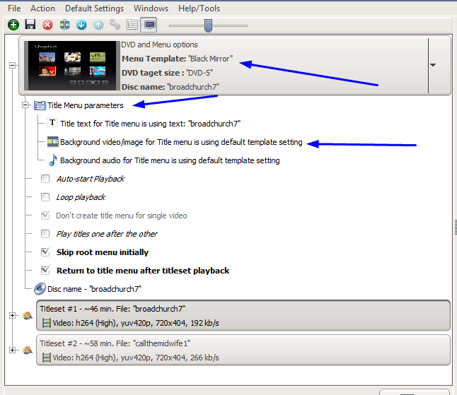

To cutomize the background of the TITLE menu:
2. In the treeview, underneath the menu selection and above your titlesets, click on "Title menu parameters" and click on "background video/image for title menu..."
