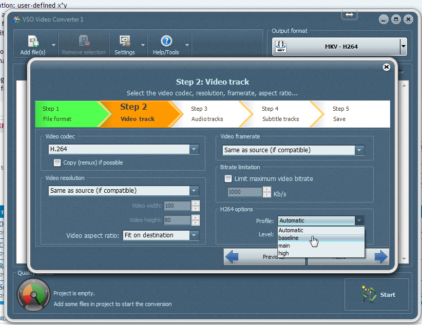

Hi Claire, can you tell me where to set the option "Baseline"?
When i create a new custom-profile i can select:
- profile-name: whatever
- container: MP4 Video
- video-codec: H.264
- resolution: user-defined x*y
- video aspect ratio: no access
- video framerate: 25 (or same as source)
- and bitrate: 15000
But unfortunately i can't find the menu-item where to change the format. Also i've searched at "advanced edit", without success. Many thanks in advance.
Creating a profile from sample file unfortunately doesn't regard the format, so although the sample-file has "Baseline" the new profile-from-sample-file will create "High@L4.1".

Re: Framerate change at iPod-profile
if you select mp4 container and video codec H.264 check H264 options (see screenshot)
this is in beta version 1.4.0.8
So i'll download the beta...
Thanks Claire, that's all i've wanted^^.
