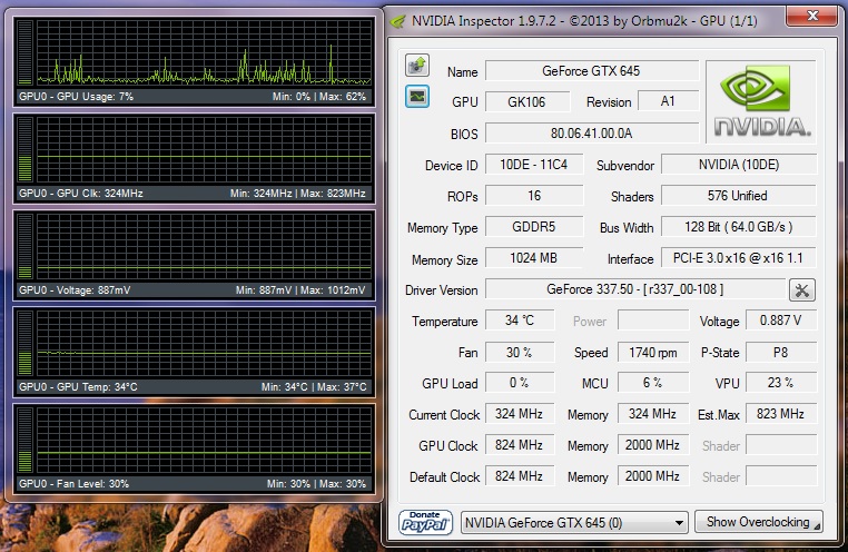

The output Blu-ray folder was only 3.6GB in size. Audio track 1 was missing with no sound (should have been DTS core 5.1) but audio track 2 was present (AC3). Video file size was extremely small considering original file size and quality. Also, very little hardware assist is being utilized. Attached are the log file and clip of hardware utilization.

Cuda support is still not performing to previous versions. Attached is graphic clip of Cuda usage during conversion. Framerates are down from 75-80 fps to 35-40 fps.

I've installed v16b and used my custom 1080p remux profile on my test standard mkv file with dts hd 7.1 audio and did a conversion. The conversion process was much faster at 75 to 80 frames per second and the invidea inspector verified a high utilization. The blu-ray m2ts file indicated the presence of both the dts extracted core and ac3 audio streams. Upon playing the folder, the video was choppy and pixelated and the dts audio stream did not play but the ac3 did play.

Cuda support is working well with a high utilization of the hardware. Picture is attached showing utiliztion.
