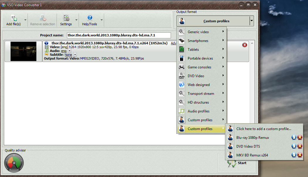

Thanks again for the quick development of the audio remux, but I now have a different problem that results in my not being able to choose any of my custom profiles. I have two(2) custom profile categories (see attached pic Custom Selections.png) on my drop down menu and when I choose a custom profile all it says is "custom profile" not my custom named profile(see attached pic Custom Selections2.png). So I am unable to try out the new audio remux settings. Do you think a clean reinstall would help? I hate to loose my settings and license.
Custom Selection
Custom Selection
Just Custom Profile, Not my named profile
9/12/14 11:30am Did a clean reinstall with the same results.

scorpion90 wrote:Hi Cedric,
9/11/14 11:30am Did a clean reinstall with the same results.
9/12/14 3:00pm - Installed version 1.4.0.22 and it fixed the issue! Now on to testing the audio remux function.
