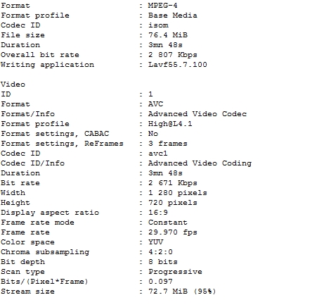

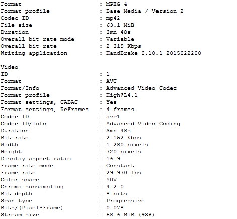

Check on Format settings, CABAC and ReFrames are different. That is enough to invalidate any speed comparison.windale wrote:For your information I used exactly the same settings (that are visibly changeable).JJ wrote:How about comparing EXACTLY same settings?

ConvertXtoVideo SOFTWARE converting (custom profile) reports the H264 profile as MAIN even though I have it set on HIGH, yet another bug.

Problem reproduced and fixed, thank your for reporting.The custom profile in the latest version keeps remuxing the video even if you turn the option off. It won't re-encode.
@JJ: I think that the video track has been reencoded / no remuxed inyour case because the source file codec was not compatible/remuxable with the select output container.
