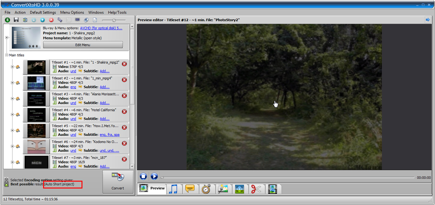

1. I added almost 20 mp4 files to the project for Disc 1. I kept adding files so long as the program said "Best Quality", when I went over and the program said "Acceptable", I dropped back a few videos until it went back to best quality. Should I bring down the number of videos for a blu-ray 25GB disc to improve quality?

If you want the quality to be better, or to get the best quality possible
Keep the encoding profile set to automatic but next to the street light/ quality advisor in the main interface only allow it to remain on "short project" remove any videos if it switches to medium so you get back to short.
That alone should make a difference.
I'm not sure this will change anything but to take things one step further, if your project is set up auto - short. Then change the target size to something even bigger, like 25% bigger in size, this way you will be sure no compression will be applied during the conversion (to force the file to fit on the target size)
