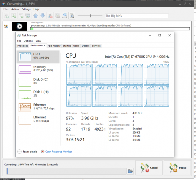

Sorry for the delay.
As you can see
all CPUs are busy with this conversion from Blu-Ray to MKV.
Have you set the number of cores used for encoding & decoding in the conversion settings?
If you remux the video far less cores will be used.
Dependening on which hardware acceleration you use CPU can be nearly ignored.
I hope this answers your question.
