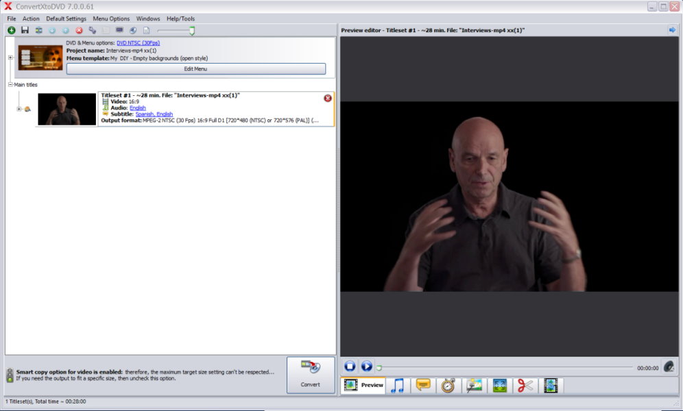

If you're desperate for that movie, this is how I managed to convert it.
1) Convert the movie to another HQ format. I used the conventional MKV (container for MP4) on Aiseesoft Video Converter Ultimate.
2) Using MkvToolnix (MkvExtract). Extracted all components.
3) Using MkvToolnix (MkvMerge). Added the converted movie file plus the English and Spanish subs and chapter points.
Converted perfectly. VSO need to look to this. But it will probably take an eternity + a day
