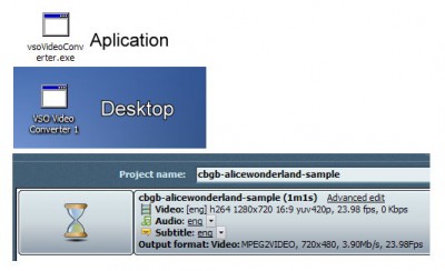

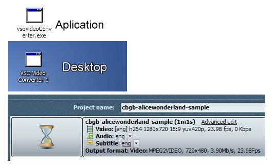

I have again uninstalled the converter and installed it again. Still not converting MKV files. It just freezes.

I get the freezup a second or two after the conversion begins. The problem only appears to be with MKV. No problems with the previous version 1.2.0.15. There is no application icon too. And the thumbnail only appears when the conversion begins. At the moment I would rarther stick to WinXP on both my machines. Since I have very good video capturing hardware which will not work well on Win7

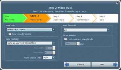

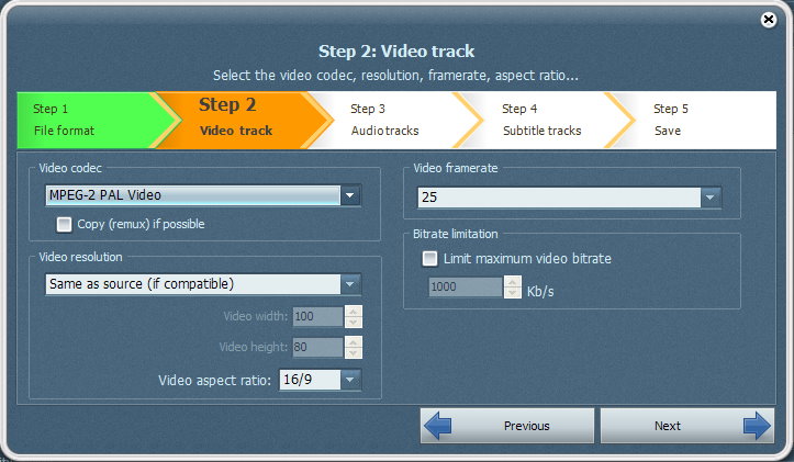

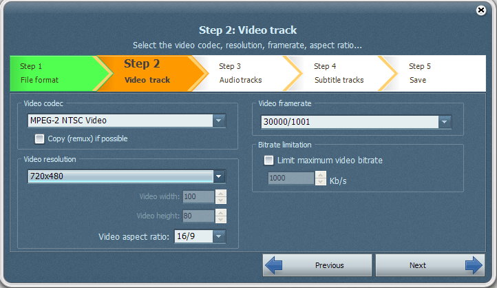

I have a couple of MKV clips which I use for testing and both of them produce the same problem. Both these clips happen to be NTSC 23.98 fps. See MediaInfo property file. I have noticed that when I have edited a coustom profile to NTSC it is saved with PAL frame rate.
See image.

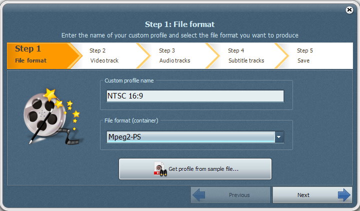

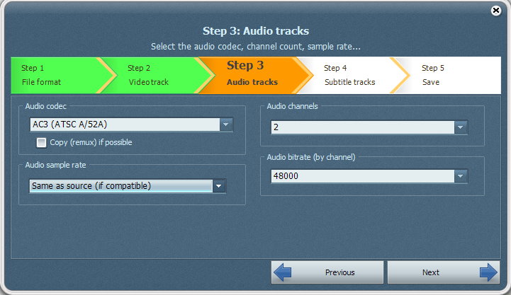

Can you give more details, like what is your output exactly?
Custom - what is on each stage of setup?
Re: Latest beta version 1.2.0.16
I think it is best to post the MKV files for inspection. These are my profile settings:
