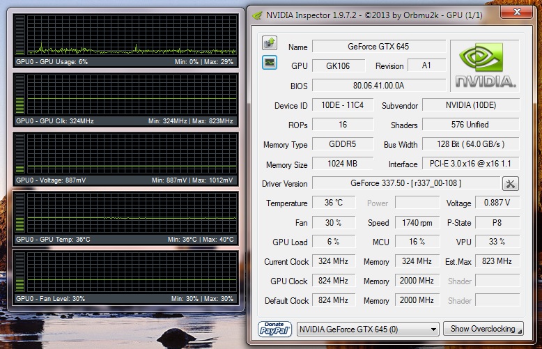

Cuda support is still not performing to previous versions. Attached is graphic clip of Cuda usage during conversion. Framerates are down from 75-80 fps to 35-40 fps.
Attached is the log file for the conversion.

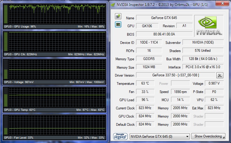

Cuda support is working well with a high utilization of the hardware. Picture is attached showing utiliztion.
Thanks, please keep working on the audio support.
