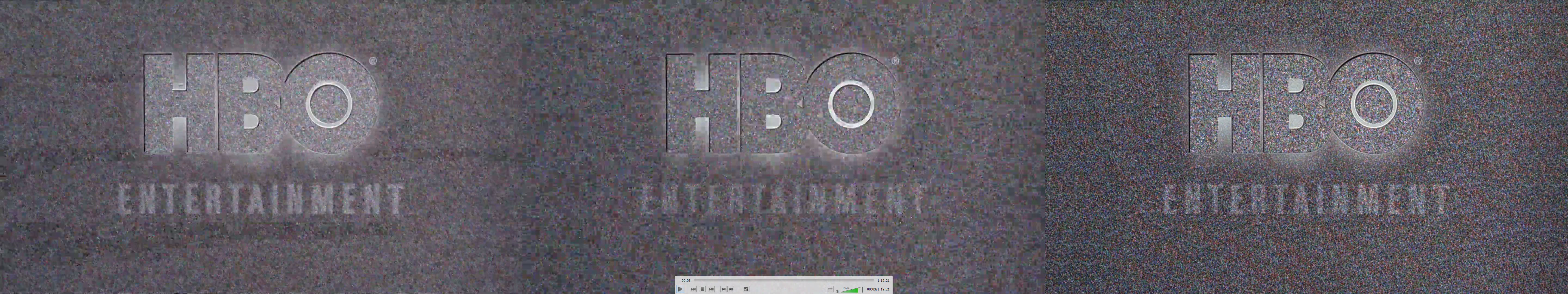

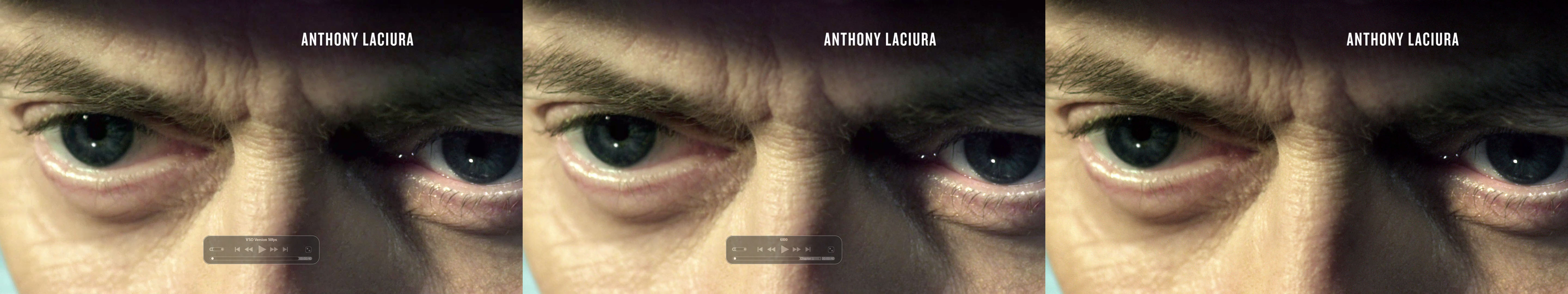

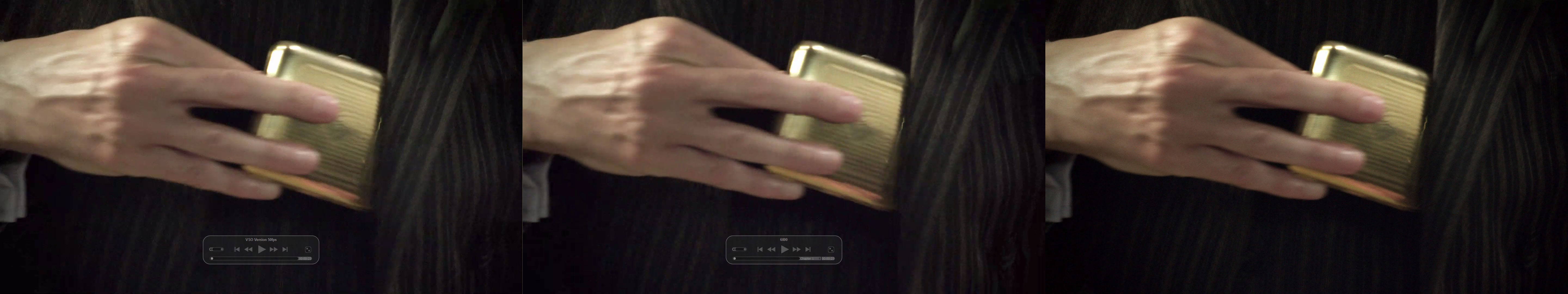

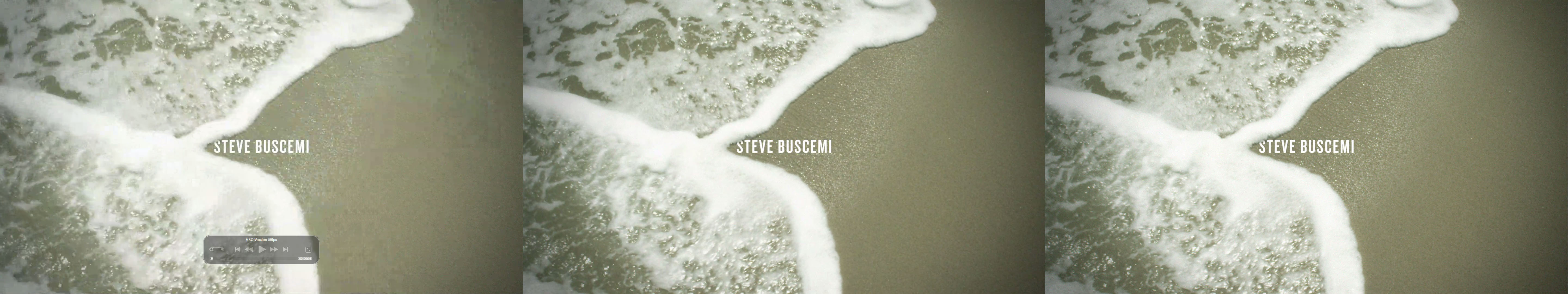

Here are some screen shots using the latest 1.4.0.13 version of Video Converter. CUDA now working, although seems to be much slower. This could of course be down to the better quality settings that have been implemented. Previous working version I was getting around 150-180fps, this new version only getting around 50-60fps.
Quality does look like it has improved, especially on slow moving sections. Fast moving video does still show blockyness. Played back in both VLC and Quicktime - did not make any difference.
All shots on Left are VSO Video Converter bitrate 6000. 3.30GB
All shots in the middle from DVDFab bitrate 6000. 3.13GB (get similar quality, size with Handbrake)
All shots on right from DVDFab CFR(Constant Quality) 20. 3.3GB (get similar quality, size with Handbrake)
Definitely looks like things are moving in the right direction
Re: Doing something wrong - custom profile terrible results
Yeah, it's completely clear to see that CRF Quality wipes the floor with everything (and that's only set at 20). If DVDFab can do it (Lightning fast with GPU/CPU acceleration) why can't VSO. It seems like they don't want to add the option but only tweak their current renderer. Hopefully in the near future.
