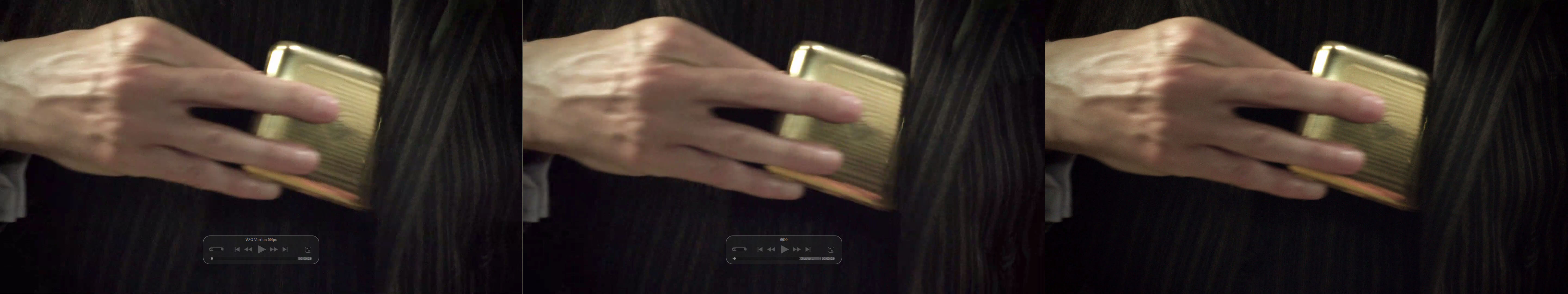

Here are some screen shots using the latest 1.4.0.13 version of Video Converter. CUDA now working, although seems to be much slower. This could of course be down to the better quality settings that have been implemented. Previous working version I was getting around 150-180fps, this new version only getting around 50-60fps.
Quality does look like it has improved, especially on slow moving sections. Fast moving video does still show blockyness. Played back in both VLC and Quicktime - did not make any difference.
All shots on Left are VSO Video Converter bitrate 6000. 3.30GB
All shots in the middle from DVDFab bitrate 6000. 3.13GB (get similar quality, size with Handbrake)
All shots on right from DVDFab CFR(Constant Quality) 20. 3.3GB (get similar quality, size with Handbrake)
Definitely looks like things are moving in the right direction

Yeah, it's completely clear to see that CRF Quality wipes the floor with everything (and that's only set at 20). If DVDFab can do it (Lightning fast with GPU/CPU acceleration) why can't VSO. It seems like they don't want to add the option but only tweak their current renderer. Hopefully in the near future.

Doing a few more tests things get even more daft
DVDFab has the option of using Intel Quick Sync and their silly fast options called Lightning Recoding and Lightning Shrink. Putting the same episode through that on my i7-3517U laptop with a CRF value of 16 converted in 6 mins with a file size of just 2.95GB - YES 6 mins - bonkers. The same conversion without Quick Sync and I am looking at 2 hours! If I put the same episode through my Xeon desktop it took 25-30 mins (software encoding only as it does not have the option of Quick Sync) VSO did the same task in about 20mins with CUDA enabled, previous versions it was doing the it in about 15-17mins.
As for the quality - the 6 min conversion looked fantastic
I am sure that VSO will implement something similar to the engine they used in ConvertX as that produced stunning results.
