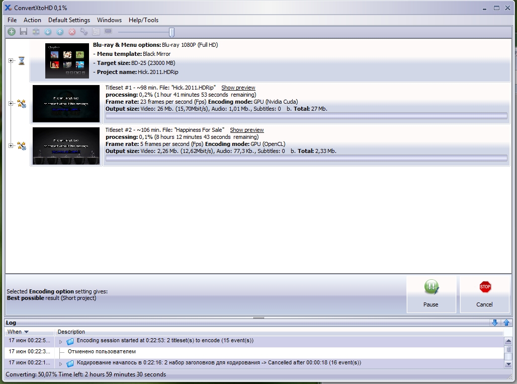

It's strange but encoding with CUDA goes only in one proc. on my GTX590. Maybe it's because of latest NVidia drivers? ver.353.06
