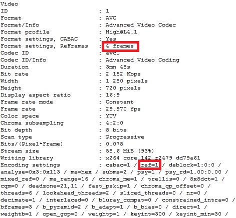

When converting with Handbrake Very Fast Preset, MediaInfo still reports it as 'Reference Frames 4'
I have all Hardware Encoding/Decoding turned off in CXV. Yours is nearly triple the encoding time, thats why I thought about De-Interlacing as it matches yours for the encoding time/frames per second.
Re: MediaInfo reports different settings were used
Yes I can see that Handbrake encoding settings ask for 1 ref frame (like it should with veryfast preset) but output file detected as using 4 ref frames...
I don't know if it's an Handbrake problem or a Mediainfos problem...
I will wait for your tests with next beta version (where 1 ref frame will be used) to compare encoding speed.

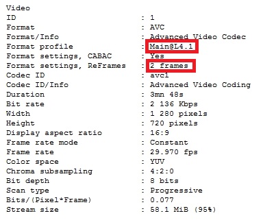

v1.5.0.36
Points 1) and 2) above, seem to be fixed, now it's just problems with point 3).
Used the same clip as before.
High 4.1
Very Fast Preset
It now says 2 Reference Frames, I thought you said you had set it to 1 (which is the correct setting for the Very Fast Preset)
And now the Profile says Main 4.1 when I have it set as High 4.1.
It's converting a little bit quicker but I can't make a direct comparison until your presets and profile are finally set correctly. Thanks.
That's I do actually. This can explain the problem you got with your handbrake result check: Mediainfo is not able to detect the real ref frames count...
Will try to reproduce tomorrow.
I will add the H264 setting sent to encoder in log too.

This is what MediaInfo is reporting your presets as when I use High 4.1 :-
Ultra Fast
Baseline 4.1
No CABAC
1 Reference Frame
(All Same as Handrake)
Super Fast
Main 4.1 (Should be High)
2 Reference Frames (Should be 1)
Very Fast
Faster
2 Reference Frames (Same as Handbrake)
Fast
Medium
3 Reference Frames (Same as Handbrake)
Slow
5 Reference Frames (Same as Handbrake)
etc.
I cannot tell the exact settings that CXV is using because it doesn't list them but I am comparing to Handrakes "Encoding Settings" list at the bottom of MediaInfo.

I did a clean install of your program and created a new profile but it still gives the same results. As I noted above, you previously fixed the Format Profile displaying Main instead of High when selecting High 4.1 (in MediaInfo) on a previous version but now it's incorrectly set/detected again. It does say High 4.1 in the log but who can tell if that's correct either ?
EDIT: MediaPlayer Classic also detects it as Main instead of High.
The log doesn't say anything about Reference Frames, MediaInfo detects that 2 frames instead of 1 for the Very Fast Preset. Speed tests are a bit faster than when it said 3 Reference Frames but i'm guessing that your program is still setting the wrong value.

Can you please update your custom profile by checking the "Use 8x8 transform" option in H264 settings?
I should have called this option "Use 8x8 transform (needed for high profiles)", not "Use 8x8 transform (only for high profiles)"
windale
Posts: 68
Joined: Fri Oct 17, 2014 10:16 am
Post by windale »
Yes, setting the 'Use 8x8 transform' to ON correctly sets the Format Profile to High. Maybe you should move these three options (Use mixed references, use 8x8 transform and use loop filter) back to the advanced section as they are not really beneficial when using H264 Presets.
It still says 2 reference frames though (on Very Fast and Super Fast Presets), and still twice as slow as Handbrake.
