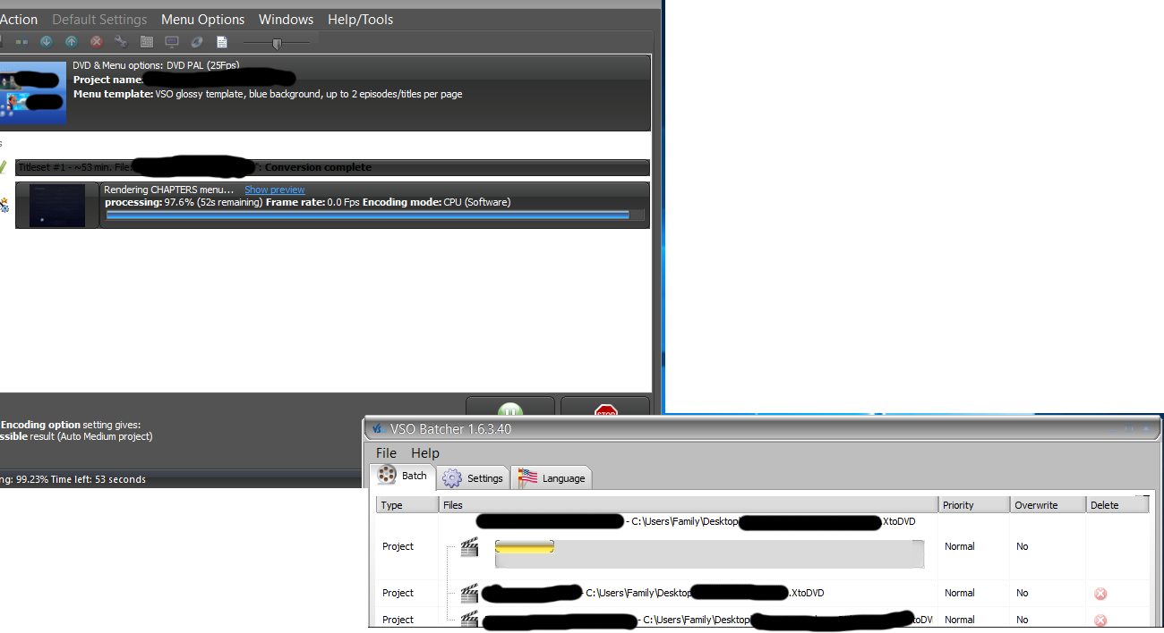

Re: ConvertXtoDVD 6 Batcher
Hi Felicia,
Yes that does happen.
As you can see in the attached screenshot ... the project has nearly finished, yet the progress bar in VSO batcher has stopped at approximately 10%.
I hope this help.
Many Thanks
kryten123
