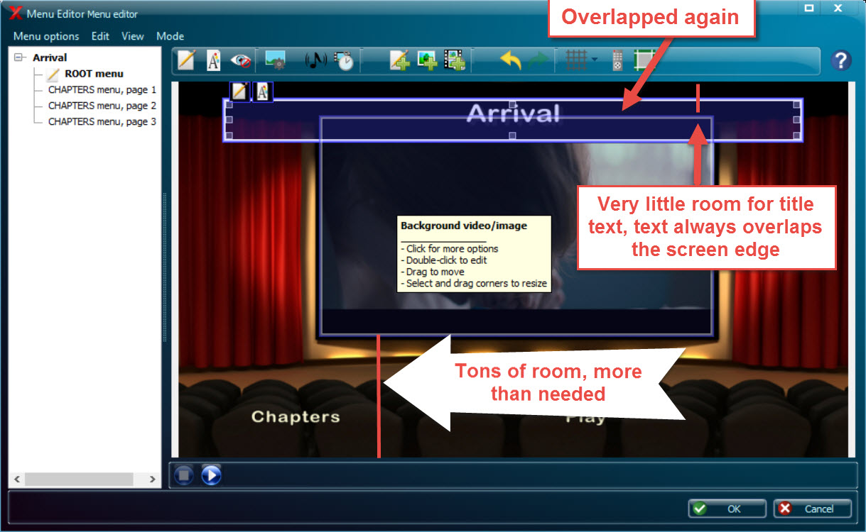

by DaveRFD
Back to seriousness here
We have some layout issues that need to be fixed in the Cinema template
As you can see, there is very little room at the top for any title text above the Cinema screen, it's very cramped up there. While below, there is tons of room for the people to sit...too much really, since we don't have any people! I know we can move and resize the frames as required but we shouldn't have to do this every time we use the theme, that should be reserved for those few times we need something different from the norm, so the screen should be more centered as the default position instead of up high.
Again, the default position of the title text box overlaps the screen's top edge. We fixed this in V6 and if we can get the cinema screen dropped down some, to allow for larger title text, this should get fixed with that.
So far, I like the customization options, this release really seems to focus on Menu customizations.
As usual, Thanks! We appreciate your constant striving for improvement, still the best I've ever seen for this and still the fastest at getting fixes out!
Dave

Posted: Mon Feb 20, 2017 8:54 am
by Coral
Hi Dave,
Regarding your post starting with the first line "Back to seriousness here". I can't see anyting wrong with the title text.
I don't consider it a fault when it is superimposed on the title picture. You can always play about with the text and title picture size settings.
