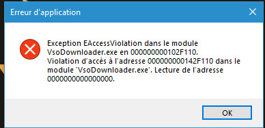

here is log file for attached error
System is W10 Home 64, 16gb ram, i7 920 2.67gh cpu, Radeon HD 7700 vid card
:vsolog_version=3
:std_log=C:\Users\Loungeroom\AppData\Roaming\vso\VSO Downloader\6\vdl6.20220206.125045.679.log
06-02-2022 12-50-58.jpg (35.32 KiB) Viewed 33437 times

Exactly the same Erreur shown here.
May be it is possible to upload a newer version (for clean install only)
per example - 6.0.0.61 - without immediate update after install (as by now 6.0.0.52),
because - it seems that this Erreur appears during the automatic update...

Posts: 256
Re: Downloader 6 beta
did clean install 2 March from version 6.0.0.52, and it updated to version 6.0.0.67.
But exact issue as I posted on 6 Feb.
It crashes giving error message, I think in French Language, same as I posted 6 Feb
Please let me know if I can help with any additional info to resolve this issue of the program crashing/ not usable.

Posts: 256
Thanks for the reply
Just downloaded on 4 March 2022 beta 6 using new email address to register
But the properties show it is version 6.0.0.52 with digital signature 24/12/21
The clean install has been done at least 6 times over the last few weeks, and program works straight after install. But next time try to run it it always crashed and gives that error message in what looks like French language

Posts: 256
Hi VSO. Thanks for the beta 60067 to do clean install off. Issue resolved thank you.

After multiple install errors I changed my Desktop PC Windows System language settings from Estonian to
English (United States) as default.
After that the next try to install VSO Downloader 6 Beta was successful.
Installed without errors, updated to version 6.0.0.70 Beta, works without errors.
So - my guess is - that the reason of those multiple errors was Windows System language (VSO Dowlnloader can
not be installed at the moment on PC with Installed Windows 10 Pro 64bit with system language - Estonian.)
Thanks for support!
