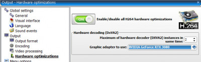

This wondering about that ''Hardware decorder' thing, if any one has any suggestions.
Thanks in advance
Thanks in advance

Eddie11013, here is the explanation of the use of hardware decoding/encoding in convertx programs:
hardware-accelerations-guide-t16234.html
Just some notes, cause this post was made in 2012:
Decoding: the limitation of hw decoding speed may vary, it's 30 fps in general, but can be faster. It can be up to 40% maximum faster than in real time (in purpose to not do competition with professional video cards).
Encoding: it's not only for users with Nvidia graphic card nowadays, almost every graphic card propose hw encoding now and convertx programs support them all. But it is still available only for blu-rays, not dvd, cause the hw encoding with mpeg2 codec used in dvd videos is taxed, so we don't use it.
Instances it's usually 1 or 2 max possible, so don't need to touch this option.

That part was done! Should I try and change the "Maximum of hardware decoder instances", current set at "2"?
Thanks in advance
Thanks in advance

If I may interrupt here with a related question. Does that hardware option only work with dedicated graphics cards or does it work if your monitor is using UHD and connected simply by HDMI to the motherboard?
Thanks!
Thanks!
Re: Beta testers?
For me it just shows the dedicated graphics card, not the one on the motherboard
