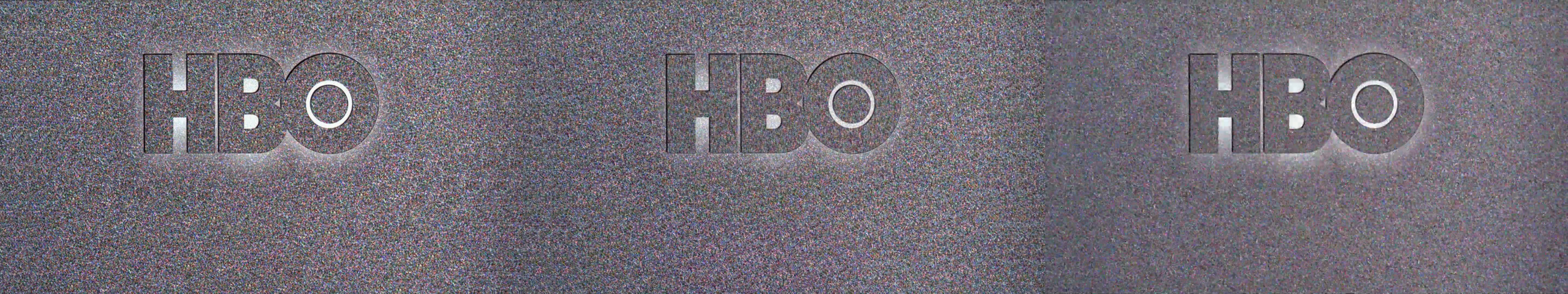

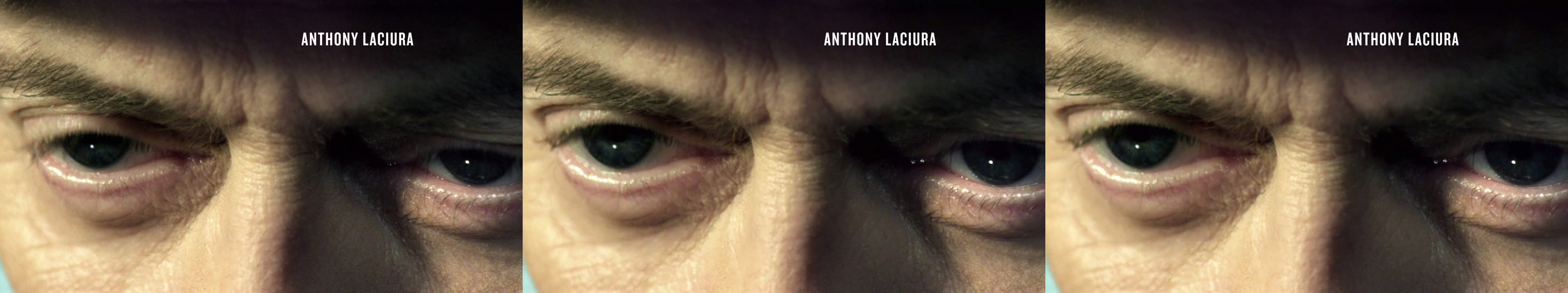

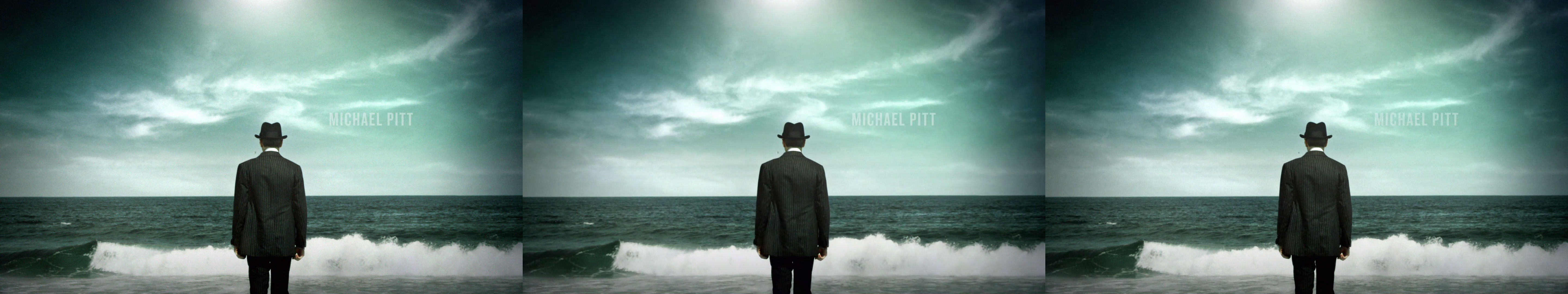

Apologies for the delay, however here are some screen comparisons.
Encoded the same episode, all at 1920x1080 full AC3 5.1 soundtrack.
DVDFab version Constant Quality setting 20 = 3.1GB (7mins to encode using Quick Sync)- I got a similar size from Handbrake so just used DVDFab as the example.
VSO version Constant Quantizer setting 20 = 1.32GB (25mins to encode using CUDA)
VSO version Constant Quality setting 20 = 2.71GB (25mins to encode using CUDA)
All images on the left are from DVDFab (CRF20)
All images in the middle are from VSO (CQ20)
All images on the right are from VSO (CF20)
Looking at these the best are obviously DVDFab (CRF20) and VOS (CQ20), however I would say that DVDFab is just slightly sharper with more detail retained. BUT there is a considerable size difference between the 2. The VSO version is half the size of DVDfab :D . I am sure that if I lowered the CQ value then the detail would remain and the file size similar to that of DVDfab. :D

That clearly shows that VSO CRF Quality is definitely not working properly, the top two sets of images (right image) look horrible. Hopefully Cedric is in the process of fixing this as it should look the same as the DVDFab ones.

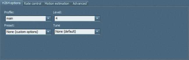

The new version 1.4.0.18 is looking nice and tidy. I recently did a few quick tests and I think i've found the problem to the poor CRF quality.
In the x264 custom profile, CRF quality set to 20 (for example)
profile set to main :
x264 Main.jpg (9.27 KiB) Viewed 13334 times

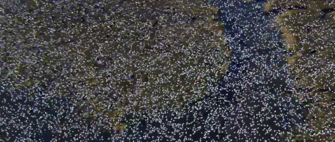

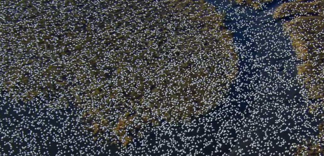

The resulting encode
If you set it to high :
x264 High Problem.jpg (9.29 KiB) Viewed 13334 times
The resulting encode looks like a complete mess
