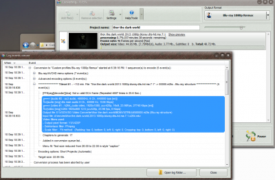

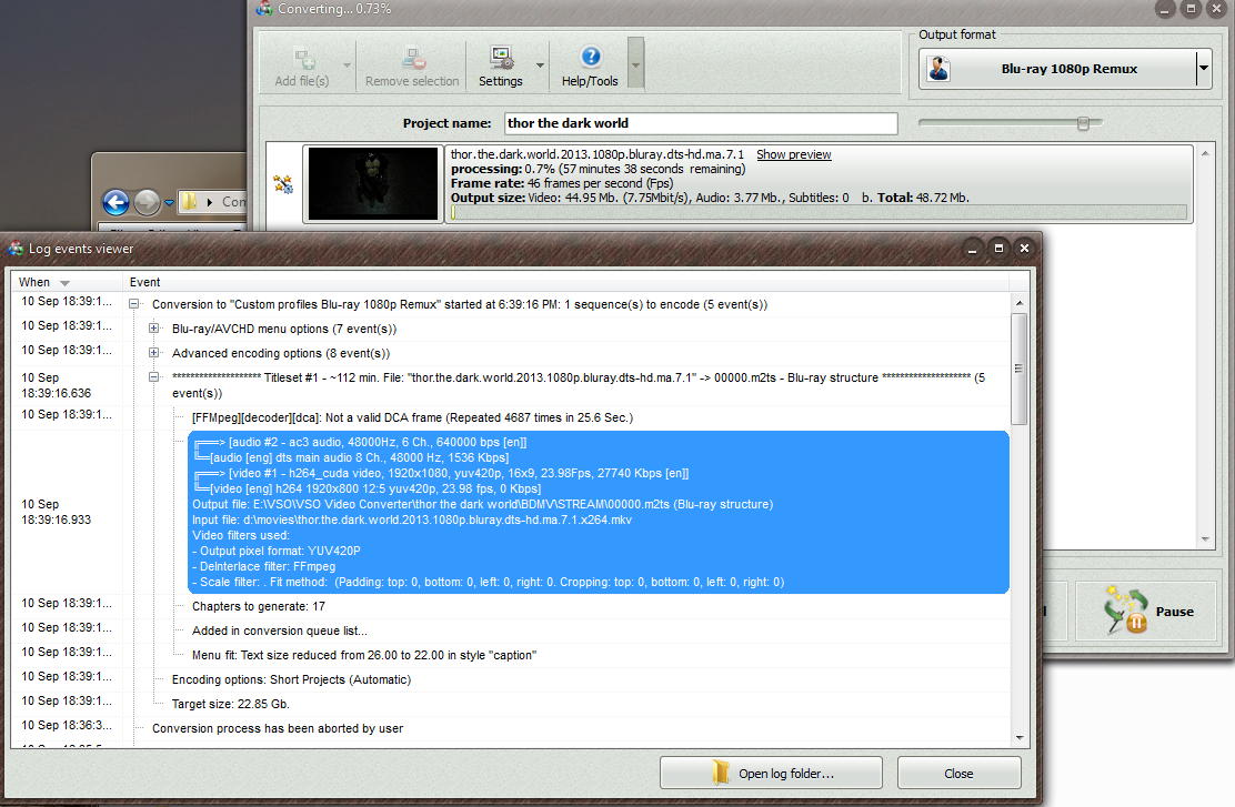

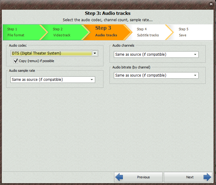

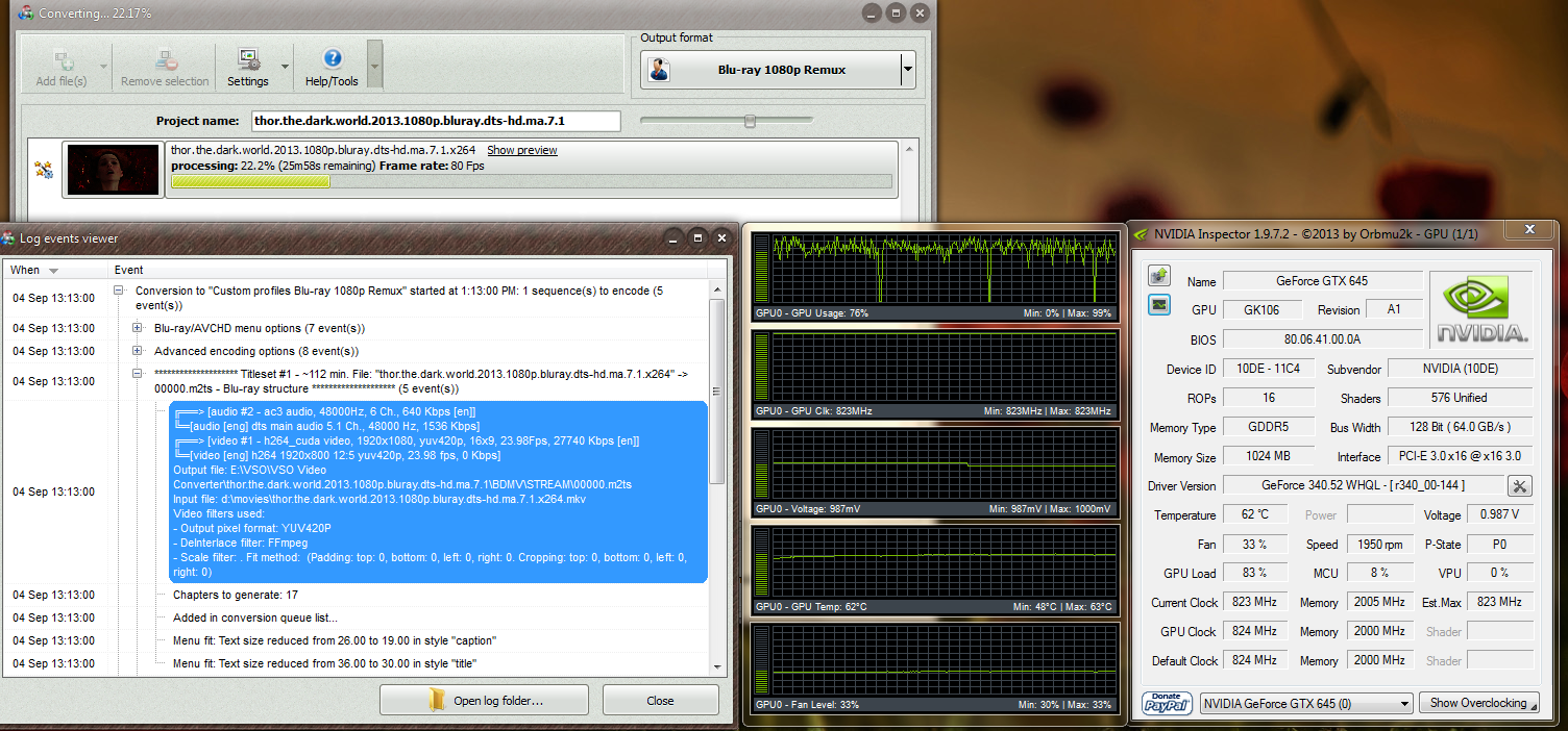

I've installed v1.4.0.17b and used my custom 1080p remux profile on my test standard mkv file with DTS HD MA 7.1 audio and did a conversion. The conversion process was much faster at 75 to 80 frames per second and the invidia inspector verified a high utilization (see attached pic v1.4.0.17.png).
The conversion did not respect my audio settings of DTS and remux if possible. The software reported just the 5.1 core of the DTS audio and during the conversion it converted it to AC3 instead of DTS! (see attached pics v1.4.0.17.a.png and v1.4.0.17.png).
Hope this helps improve audio issues, Thanks,
Tony
[attachment=1]v1.4.0.17.png[/attachment]
[attachment=0]v1.4.0.17.a.png[/attachment]
Tony

Re: Feature Request: High Definition Audio for AC3 and DTS
Thanks Tony...so you're not seeing a reduction with latest beta, are you using NVIDIAs newest driver too?

Hi Mojo,
I am using "340.52-desktop-win8-win7-winvista-64bit-english-whql" driver which I believe is now the latest for my Geoforce GTX 645.
Tony
Tony

Loaded up version 1.4.0.18 and ran a conversion of my standard mkv file with DTS HD MA 7.1 audio and got the same results as version 1.4.0.17. See above post for version 1.4.0.17 issues.

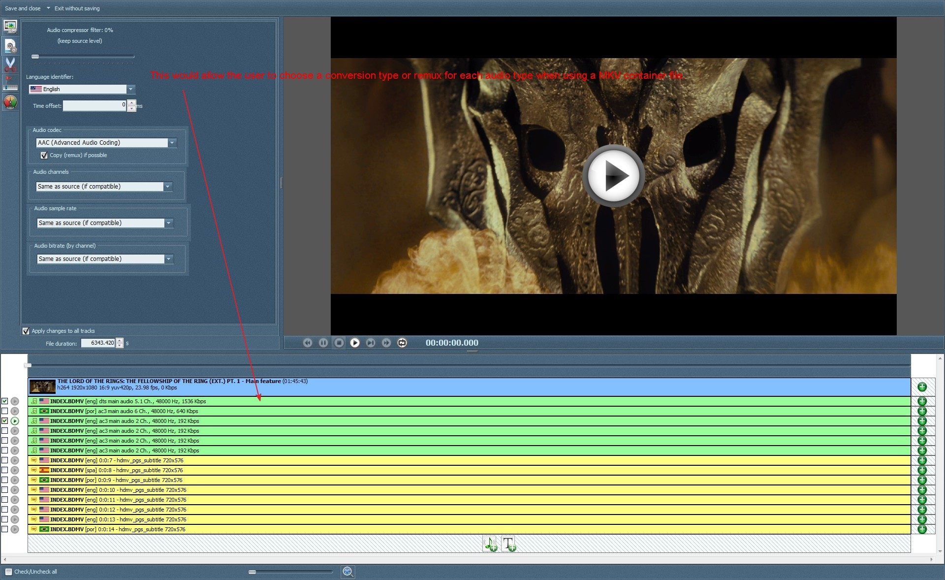

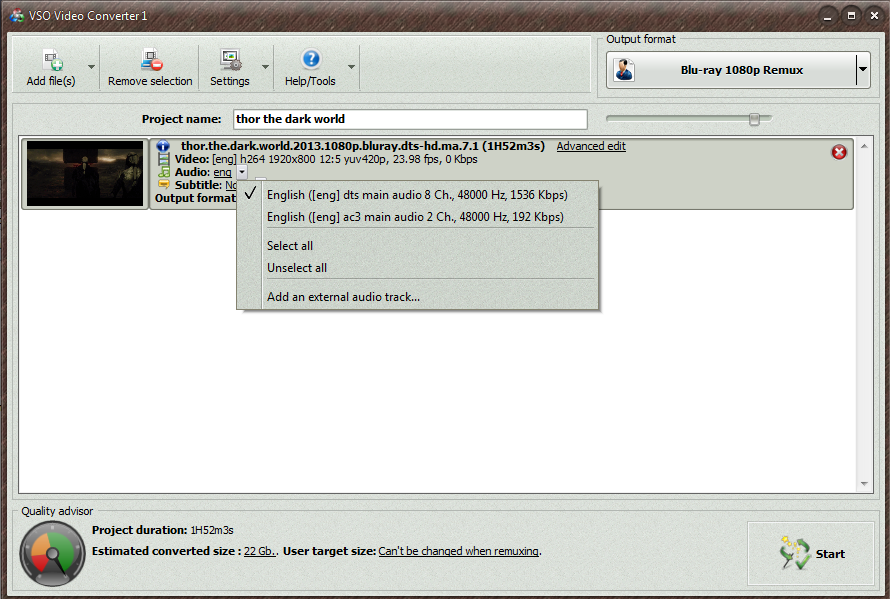

Can I make an addition to this request for that coming feature? When giving the user the choice of remuxing/converting audio files, can you incorporate the options in the "Advanced edit" window, and allow for selection of which audio type to remux and which to convert to a different codec? This would allow the user to convert AND remux audio files for a MKV at the same time......Is this possible?
Please see edited screenshot as an example to see what I am referring to.

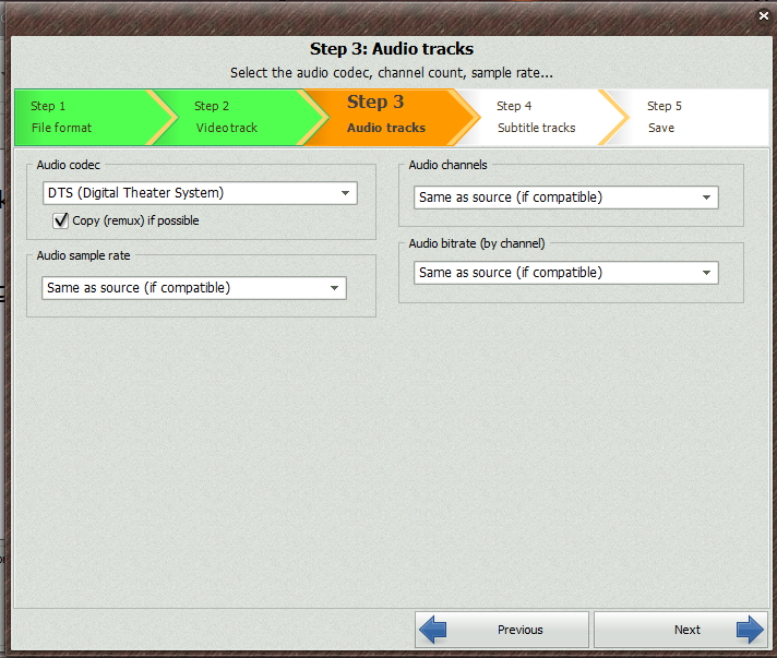

Thanks for the quick work on the audio remux. I installed version 1.4.0.20 and did a conversion with my baseline mkv file with DTS HD MA 7.1.
I double checked to make sure my custom remux file had the proper properties per the following picture (Audio 2.png). The program correctly identified that the audio was DTS 8 channels by the following picture (Audio 1.png). When I did the conversion, the program indicated that it converted the file from DTS 8 channel to AC3 6 channel per the attached picture (Audio 3.png). The program is now at least identifying the full audio stream (it says DTS Main which I assume means the full DTS HD MA audio stream).
I will also try with AC3 TrueHD and report results, but that was working previously.

Hello scorpion90,
Thank you for your screenshots.
"When I did the conversion, the program indicated that it converted the file from DTS 8 channel to AC3 6 channel"
My tests was using mkv output format, and I forgot to check Blu-ray output...
The DTS 7.1 audio track will be remuxed (bug reproduced/fixed) with next beta version (coming today)

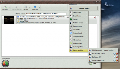

I tried default MKV remux, and it worked great for the DTS but not PCM. I am assuming this is because it's not supported yet?
Are there plans for remux to work in custom profiles?
