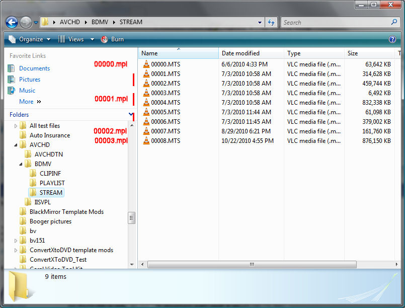

When picking the AVCHD folder shown in the image, only the files in the 00001.mpl playlist are converted.
How can I get all files in the folder to convert?

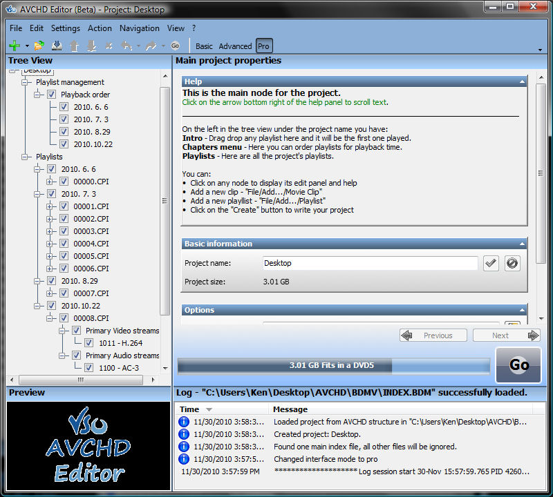

The editor picks up all files, see the screenshot.
This AVCHD folder is from a Panasonic DMC-ZS3 stilll cam that records in AVCHD Lite/short. All 9 cpi files are in the CLIPINF folder and all 4 mpl files are in the PLAYLIST folder.
- AVCHD Editor playlists.jpg (178.08 KiB) Viewed 11236 times

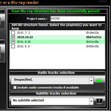

The new version did allow me to load all playlists in the AVCHD folder I sent and I can select which ones to convert. But those playlists are out of order as shown in the image below and they convert out of order. They should be arranged with 6.6 first followed by 7.3, 8.9 and 10.22 which are recorded dates as shown in Files converted.jpg above.

- Playlists.jpg (55.74 KiB) Viewed 11154 times
You're right, we use playlist duration to sort them... but we should use creation date!
