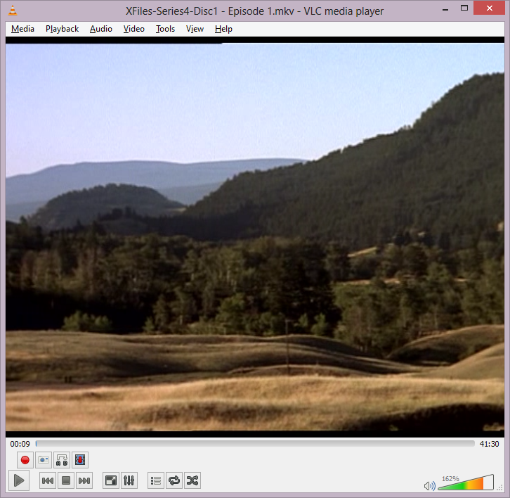

Default view
[attachment=2]5-3RatioProblem1.png[/attachment]
Full screen
[attachment=1]5-3RatioProblem2.png[/attachment]

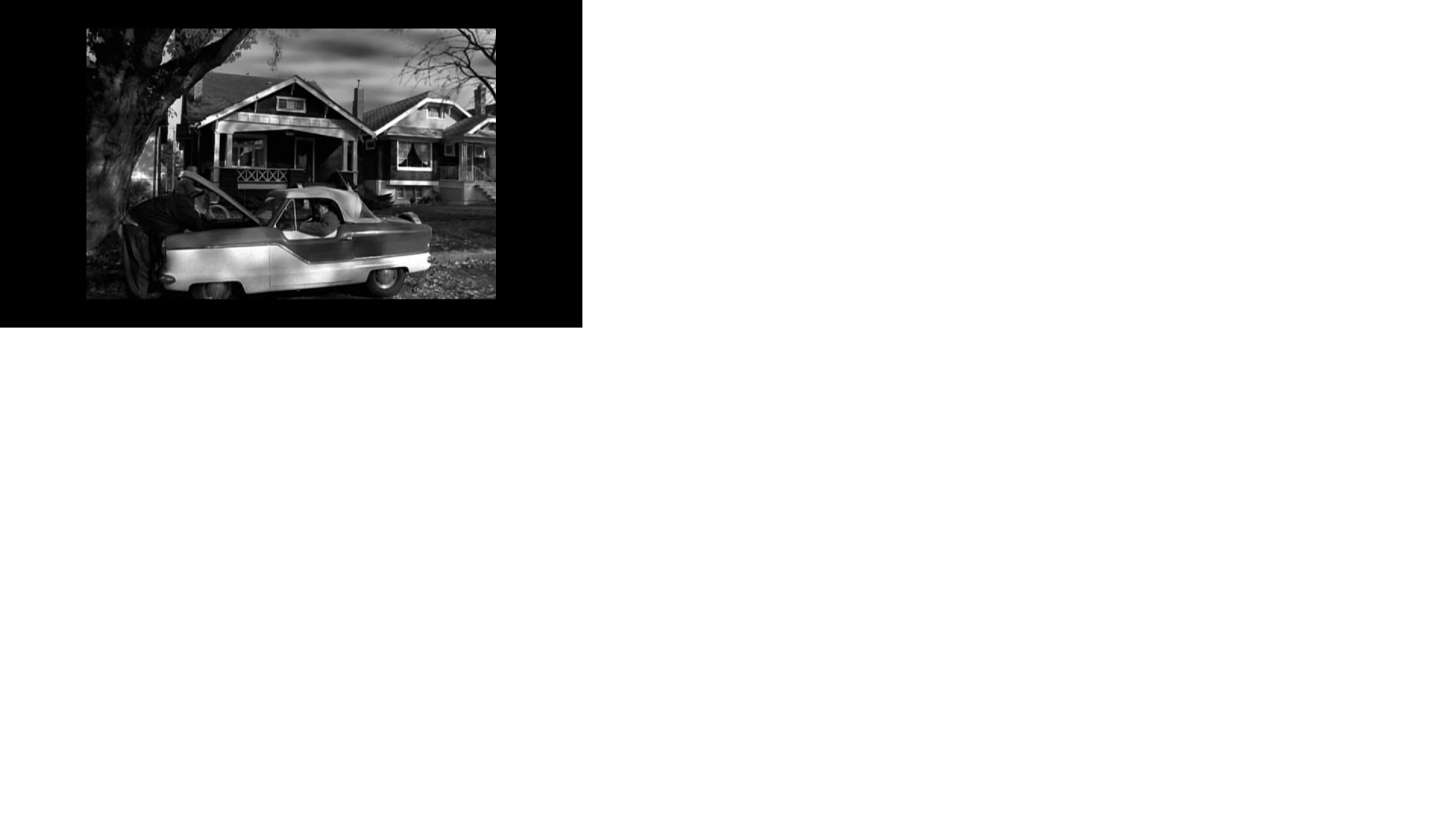

This did not happen in previous versions;
[attachment=0]5-3RatioProblem3.png[/attachment]

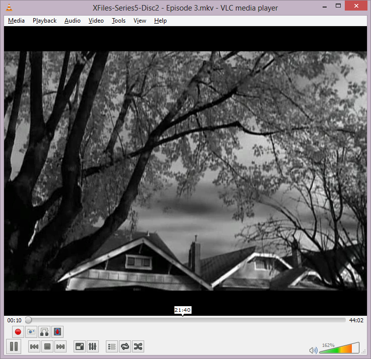

I've noticed this happening on other ratios when converting films. When putting the converted file into full screen I have large black boarders on every side
Default view
Full screen

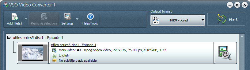

Something of note: see attachment for when the dvd was added. You can see the black borders before the conversion starts
[attachment=0]VsoBug-InitialLoad.png[/attachment]
