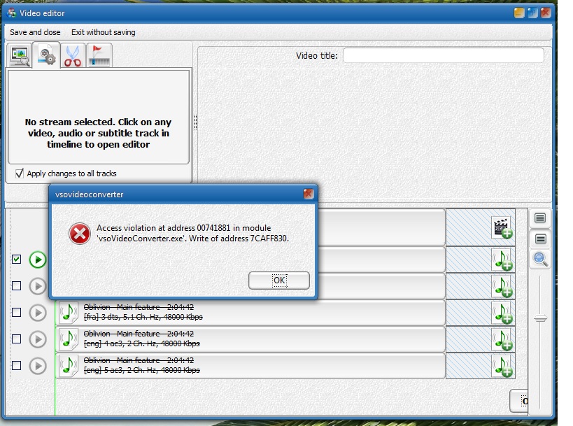

Ever time I try to edit a bluray project property I get this error.(see attachment)
DVD Projects seem to work fine.
Tried Stable Version and latest beta
Video converter - 1.1.0.10 and have tried more then one bluray source
Sat32

Is any one else getting this??
I just uninstalled used VSO Cleaner and reinstalled the last beta.
First movie I tried seemed to go ok.
Then tried to do another movie and it started this again
and ideas??

Testing Results
I cleaned up what vso software was on the system.
Uninstalled Video converter 11b, ran VSO Cleaner and deleted
username\apps\roaming\VSO
ProgramFile(x86)\VSO
ProgramData\VSO
Then rebooted the system.
Then installed video converter 12b and entered unlock code.
Without making any changes I drag and dropped a bluray folder ripped by anydvdhd into the converter.
Then I went into the editor and without getting the access error.
I closed the editor and went into settings and changed, output destination, don't create chapter and checked the add addition track for forced subtitles.
closed setting
Went back to the editor and got the access violation error this time.
Closed the coverter and started the project again.
Results I found:
If you open settings while a project is loaded, editor causes a access violation.
Make Setting changes before loading projects.
