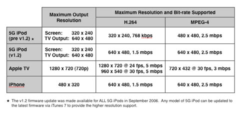

Technically; iPod has lcd pixel display. It does not really care about FPS. You should be able to convert to 25FPS video as long as you keep video screen size in iPod limits. Internal display is 320x240 pixels but it can output 640x480 to TV. Both these resolutions are NTSC and NTSC FPS on TV is 29.97FPS.
You might be able to convert to 640x480 and use 25FPS, but that is non-standard and there is no quarantee that it works. If treadmill has also lcd display then it most likely will play that file.
Treadmill seems to be PAL if it has 25 or 50FPS, and most PAL systems can play NTSC files without any modifications - they just slow down a little due more frames every second. (ie; total playing time increases, 5 seconds of PAL plays 125 frames but 5 seconds of NTSC has 150 frames so it takes 6 seconds to play 5 seconds of NTSC original in PAL)
Of course it is possible that treadmill can recognize NTSC and drops frames accordingly to keep playing speed - that makes stuttering.
  • iPod video specifications from Apple’s website:
    H.264 video: up to 768 Kbps, 320 x 240, 30 frames per sec., Baseline Profile up to Level 1.3 with AAC-LC up to 160 Kbps, 48 Khz, stereo audio in .m4v, .mp4 and .mov file formats
    MPEG-4 video: up to 2.5 mbps, 480 x 480, 30 frames per sec., Simple Profile with AAC-LC up to 160 Kbps, 48 Khz, stereo audio in .m4v, .mp4 and .mov file formats
    iPhone video specifications from Apple's website:
    H.264 video: up to 1.5 Mbps, 640 by 480 pixels, 30 frames per second, Low-Complexity version of the H.264 Baseline Profile with AAC-LC audio up to 160 Kbps, 48kHz, stereo audio in .m4v, .mp4, and .mov file formats
    H.264 video: up to 2.5 Mbps, 640 by 480 pixels, 30 frames per second, Baseline Profile up to Level 3.0 with AAC-LC audio up to 160 Kbps, 48kHz, stereo audio in .m4v, .mp4, and .mov file formats
    MPEG-4 video: up to 2.5 Mbps, 640 by 480 pixels, 30 frames per second, Simple Profile with AAC-LC audio up to 160 Kbps, 48kHz, stereo audio in .m4v, .mp4, and .mov file formats

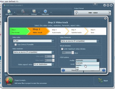

I know a lot less than what JJ is providing, but I noticed if the video codec h.264 is selected in the custom profile editor there is the option to set the profile to 'baseline', maybe a solution would be to make this setting available when mp4 video codec is selected also?
Have you tried in the custom profile editor in the 1st step, to "get profile from sample file..." and convert to a profile made from that sample? does that work?

Hi Claire, can you tell me where to set the option "Baseline"?
When i create a new custom-profile i can select:
- profile-name: whatever
- container: MP4 Video
- video-codec: H.264
- resolution: user-defined x*y
- video aspect ratio: no access
- video framerate: 25 (or same as source)
- and bitrate: 15000
But unfortunately i can't find the menu-item where to change the format. Also i've searched at "advanced edit", without success. Many thanks in advance.
Creating a profile from sample file unfortunately doesn't regard the format, so although the sample-file has "Baseline" the new profile-from-sample-file will create "High@L4.1".
Posts: 5913
Re: Framerate change at iPod-profile
if you select mp4 container and video codec H.264 check H264 options (see screenshot)
this is in beta version 1.4.0.8
Slevin
Posts: 8
Joined: Wed Jul 23, 2014 6:00 pm
Post by Slevin »
So i'll download the beta...
Thanks Claire, that's all i've wanted^^.
