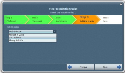

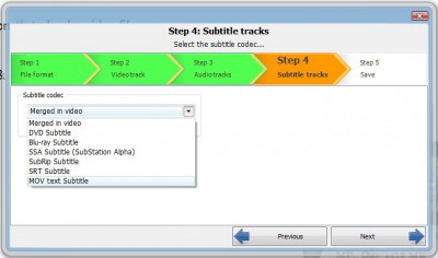

Re: Remuxed (Raw Copy) error
Okay...here are the screenshots to show the missing subtitle options in beta 1.4.0.8 that exist in version 1.3.0.0. In these photos, I have MKV selected as the container.
Thanks for the screenshots.
I think this was an error that these output subtitle formats existed in 1.3.0.0, in fact of the ones available that I don't think were intended to be listed is SRT, Subrip, Mov and the conversion fails if they are selected.
(for SSA worked, the conversion completed but I do not see the subtitles in the output file, the file info says they are there but they are not visible on the screen)
The other subtitles, Merged in Video, DVD or Blu-ray Subtitles are the only ones I think were intended to be listed there.
So you only have 3 choices for subtitles, and from what you say you don't want merged subtitles. I guess DVD subtitles would be the best, and I think the "Copy (remux) if possible would even be the best.
