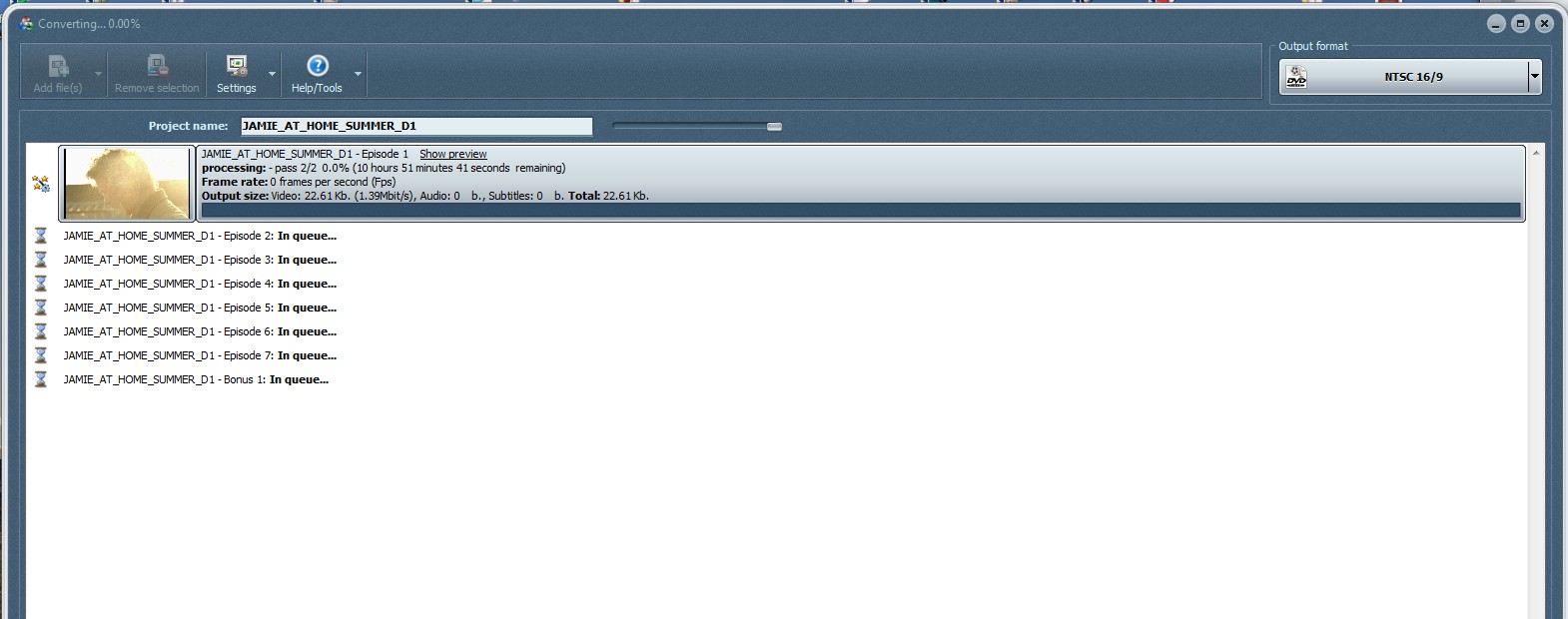

Well, I didn't get through with the conversion....found a possible bug. I will do it again with '2 pass encoding' disabled, and report back.
I was converting a PAL to NTSC with '2-pass encoding' enabled. The first pass through all of the files went smoothly, but when it went back to start the second pass it went into a 'time stamp error' loop.
I have posted a screenshot, and my crash log.
