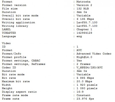

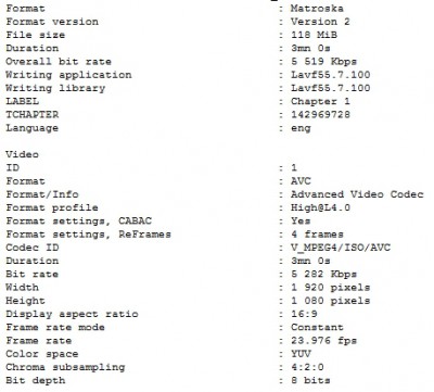

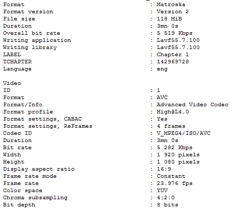

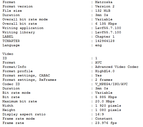

What I was trying to explain to you was this, I don't use VLC, I use a utility called "MediaInfo".
Using the same small clip for both encodes
When I encode a clip with NVCUVENC and CRF 20 I get these results :- When I encode a clip with NVENC and CRF 20 I get these results :- 1) So just out of interest, why doesn't the info for the NVENC encode tell me it's variable, average and max bitrate like the NVCUVENC one does ?
2) Why is the NVENC one smaller file size and bitrate ?
3) Why does the NVENC one say 4 reference frames when you said that reference frames don't work with GPU acceleration ? Can you disable all options completely when using GPU acceleration (in custom profile) so you cant alter them please.
4) If reference frames are supposed to work (up to a maximum of 4) then they aren't taking effect because 1,2,3 and 4 reference frames give exactly the same results.
5) I can enable nVidia and Intel QuickSync at the same time, which I should not be able to do.

If you read my previous post, I'm using MediaInfo too...?What I was trying to explain to you was this, I don't use VLC, I use a utility called "MediaInfo".
That confirm my previous reply : "Or are you assuming if "Bit rate mode: Varibale" is not displayed in MediaInfos the video is encoded as CBR?"1) So just out of interest, why doesn't the info for the NVENC encode tell me it's variable, average and max bitrate like the NVCUVENC one does ?
The video is really in VBR, your real problem is Mediainfo doesn't display the info (and you assumed no info = CBR)
Don't know why MediaInfo doesn't display varibale bitrate info on NVENC file, can check if I can add some additional metadatas...
-> because NVENC is more effective!2) Why is the NVENC one smaller file size and bitrate ?
I hope that you are not like a lot of users thinking "bigger is my file, better is the video quality"
Please, stay focused on video quality and forget the filesize (especially as I think your NVENC smaller result can have better quality!)
I never said that references frames doesn't work with hardware encoder?3) Why does the NVENC one say 4 reference frames when you said that reference frames don't work with GPU acceleration ? Can you disable all options completely when using GPU acceleration (in custom profile) so you cant alter them please.
"For the reference frames setting, I found that neither hardware encoder is able to encode using more than 4 ref frames.
NVCUVENC always use 2 ref frames when NVENC and QuickSync fail when ref frames > 4. (setting now limited in hardware encoders)"
So, reference frames will be from 1 to 4 for NVENC and QuickSync, always 2 for NVCUVENC
Why should I disable all advanced options when only one is not/partially taken in account? All other advanced options are used.Can you disable all options completely when using GPU acceleration (in custom profile) so you cant alter them please.
I don't want to disable them because hardware encoding is a separate option from custom profile, and custom profile edition must be generic.
No you can't, but I assume that option is not clear...5) I can enable nVidia and Intel QuickSync at the same time, which I should not be able to do.
Internally, the hardware encoders priority are : QuickSync, NVENC, NVCUVENC.
That mean if QuickSync is unchecked, NVENC is used. If NVENC is unchecked, NVCUVENC is used. If NVCUVENC is unchecked, H264 software encoding is used.
I will clarify this option for next version...

You must understand that if ref frame setting is not taken in account, it s not a video converter problem because the value is requested but ignored by graphic card api...
Thanks for finally managing to increase the encode speed.The last problem was the encoding speed and, if you read the log of last beta version, we worked hard on and the encoding speed should be faster (from 90 to 150 on my graphic card)
Do you use another converter program able to use more than 4 ref frames using nvenc?

I change metadata to simulate false ref frames really? How can you say that (it's totally false...)
For your information, ref frames is not a simple metadata field...
Like I said, I request a ref frame count to nvenc then encoder do what it can.
My nvenc card can't use more than 4 ref frames (I never said that ref frames doesn't works...))
If you don't trust me, you can leave this forum I think...

I have simply asked Cedric whether the reference frames work when using NVENC. He said above that it works up to a maximum of 4 reference frames but the tool tip says it doesn't work with GPU acceleration. I want to know what is the right answer. I've done a lot of testing here and now you've decided to gang up on me ?
Re: Reference Frames option doesn't make a difference
I have simply asked you whether the reference frames work when using NVENC. You said above that it works up to a maximum of 4 reference frames but the tool tip says it doesn't work with GPU acceleration. I want to know what is the right answer. I've done a lot of testing here and now I get ganged up on for doing it. Thanks.cedric wrote:I change metadata to simulate false ref frames really? How can you say that (it's totally false...)
Bye
Talking of reference frames, when encoding with NO GPU Acceleration with 2 reference frames, the MediaInfo reports it as 4 reference frames ????????????????????????????????????????????????????????????????????????
