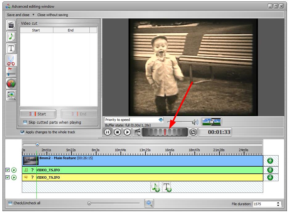

Like ConvertXtoDVD doesn't use a timeline view (with zoom and scroll), we can't use the same way for cut function.
What is the missing thing in cut function for ConvertXtoVideo now?
You can start, validate and delete a cut section like in ConvertXtoDVD.
You can find a specific image/scene using next/previous frame and playback speed functions so, I don't know what I can do more?

The rewind on the jog wheel still doesn't work properly. It seems it will only let you rewind what's in the buffer and then it keeps repeating the last few frames.

That's exactly what the jog wheel do, seek in backward buffer.The rewind on the jog wheel still doesn't work properly. It seems it will only let you rewind what's in the buffer and then it keeps repeating the last few frames.
The backward buffer keep 3 seconds of video for previous frame function.
If you want to see the picture before these 3s, a seek will be invoked and the displayed picture can be different as real previous picture.
I will check if I can implement a more precise seek there, but some files can have really big GOP and previous frame version will take a long...
Why do you need to seek backward further than 3s? Are you trying to see your movie from end to start?

Edit The rewind not working with the jog wheel, I confirm it does not work correctly. Thanks for reporting.

It might be staring me right in the face but I can't find the next/previous frame function.

Re: [Request] Is it possible to improve the cut & trim editi
the jog will will do what you want. If you click and pull (holding down) click far to right or left speed to go forward or back will be fast, moving only a little will allow frame by frame (image by image)
That is very hard to get working as intended. Why not the use previous and next buttons instead?Claire wrote:the jog will will do what you want. If you click and pull (holding down) click far to right or left speed to go forward or back will be fast, moving only a little will allow frame by frame (image by image)
the jog wheel also does fastforward rewind.
rewind only works well when on pause.
fastfoward can go much faster than rewind and works best when playing.
