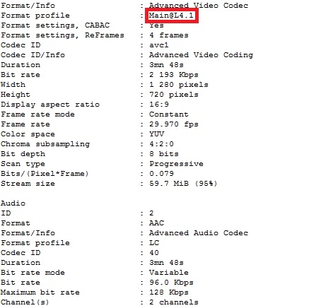

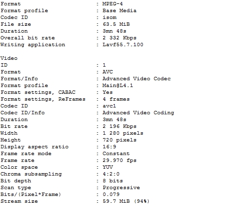

MediaInfo still says that the H264 Profile is "Main" but in CXV Custom Profile I have it set to "High". (when using Custom Profile, Software Encoding).

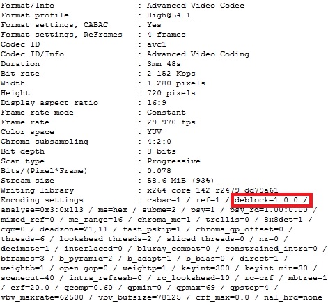

Please add option to turn off deblocking in Custom Profile. I tried using your Superfast preset but it turns off CABAC and increases the filesize for no reason. Handbrake doesn't. You're obviously using modified H264 presets.

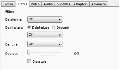

It must be something else that's making your converter slow.

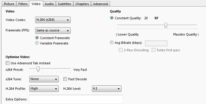

Handbrake Settings
ConvertXtoVideo Settings (Custom Profile, Software Encoding)
CXV Settings.jpg (38.78 KiB) Viewed 12068 times
Handbrake took 1m21s
ConvertxtoVideo took 3m22s
As you can see your converter H264 Profile is set to 'High' but MediaInfo says it's 'Main'.
I don't see any difference in quality between Handbrake and CXV, just yours takes longer for still unknown reasons. I obviously used a short clip to quickly show the difference, longer clips can seriously add more time on CXV.

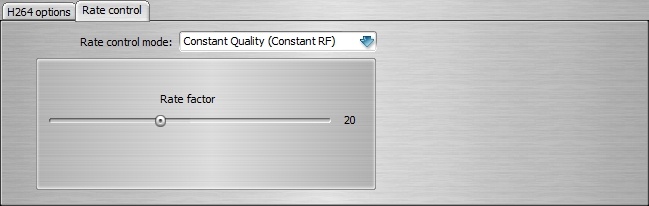

Yes I used the same settings, forgot to post the picture (I had to wait because my internet just went off).

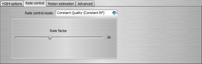

If I load your program, goto Custom Profile, set my preferences (e.g. CRF 20) and save it. If I exit your program and reload it, go back to Custom Profile some of the options are reset.

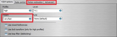

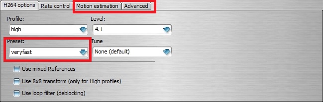

Also, when restarting the program, Custom Profile, the advanced tabs are shown even when I have a H264 preset selected.

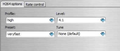

The above post still happens on v1.5.0.32 Custom Profile, Software Encoding (CRF is reset to 26 when loading program and advanced options are visible when H264 preset is already selected). If I choose a different H264 preset then the advanced tabs go away. This happens every time the program is re-loaded.
It converts a little bit faster now (but still much slower than Handbrake). The options you enabled for the H264 presets hardly make any difference at all.
Newly Added Don't make much difference.jpg (16.57 KiB) Viewed 12002 times

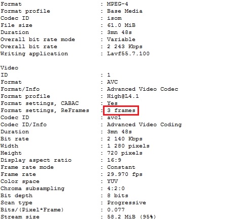

The Format Profile now says 'High' like it should because thats what I have selected but now the References Frames has gone from 4 to 3 ? I'm using exactly the same options as before.
v1.5.0.30
v1.5.0.32
Also your program gives no information in MediaInfo on what H264 settings were used (like other H264 converters do e.g. Handbrake).

Most of what I reported in this thread still happens in v1.5.0.33.

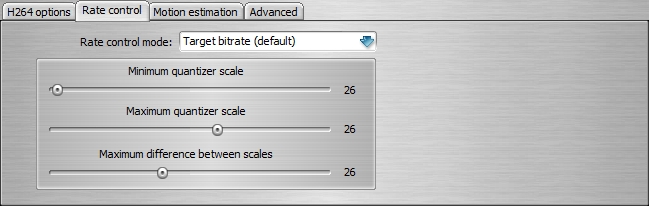

1) Custom Profile, Rate Control CRF is reset to 26 every time you load the program. (See screenshot above).
2) Custom Profile, Custom H264 tabs (Motion Estimation & Advanced) are displayed every time you load the program even if a H264 preset (e.g. Very Fast) is selected. If you reselect the preset then the tabs disappear. (See screenshot above).
3) Custom Profile, Software Encoding, when using a H264 preset (e.g. Very Fast) MediaInfo now reports 3 Reference Frames when it should (and used to say on previous versions) 4 Reference Frames. (See screenshots above).
Fixed for the next version
I think this problem was related to 2). Like advanced options was displayed even if a preset was selected, encoder used the preset default and overwritten you custom value.
Can't reproduce...

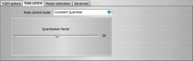

I can reproduce it every time, and it seems to happen with all the Rate Control Modes.
Close CXV
Open CXV
Goto Custom Profile and click on the Rate Control tab.
All the Rate Control Modes are at value 26.

Re: MediaInfo reports different settings were used
If your custom profile doesn't use CRF or CQ, the factor values are set to default values, it's a normal behaviour.
If you set a CRF or CQ factor in your custom profile, close the editor then reopen it and the factor is back to default, there's a problem (that's what I tried to reproduce).
The program will not use your last factor value as default, it's not safe.

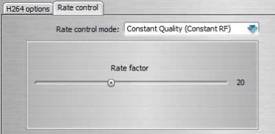

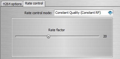

I don't understand what you're trying to say. I use CRF 20 and save the profile. When I exit the program and go back to the custom profile it says its 26 again ! This never used to happen on previous versions.
I have my Custom Profile set at CRF 20
I save the profile.
Close CXV Completely and reload it. Custom Profile Rate Factor now looks like this
Are you still working on this because v1.5.0.34 even weirder things are happening and it won't convert (It says 'An error occured while converting').
Using the same clip as before (MP4 VP9 720p) it now shows this in the encoding screen
Clip info.jpg (15.8 KiB) Viewed 11942 times
Rate Control Mode CRF still says 26, when I change it to 20 and save the profile it changes to Constant Quantizer 26 (in a different Font) !!!!!!
