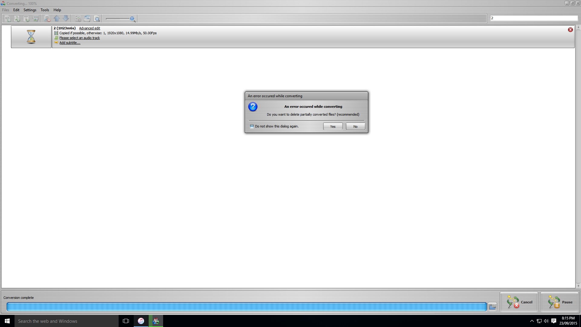

And here is a pic of the error that comes up
