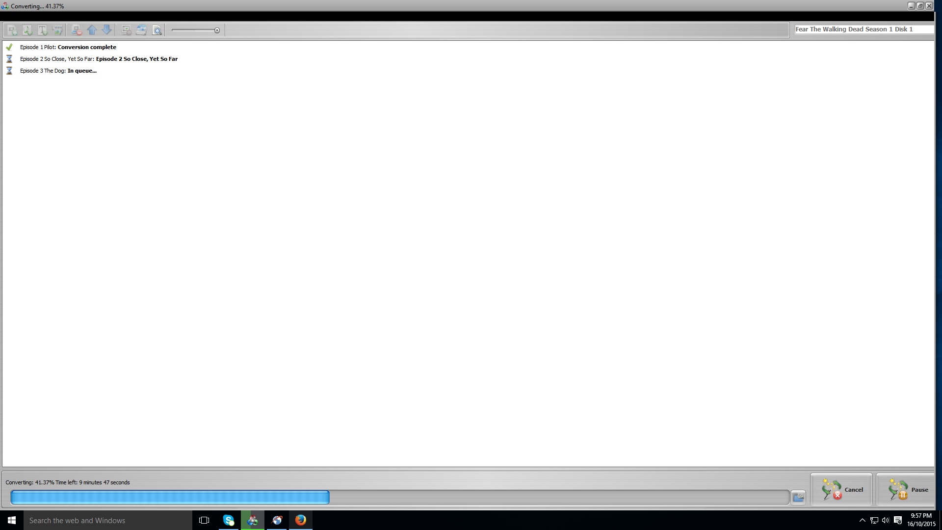

Just a bug found in 16.0.35 beta it hangs when you try to do more than 1 episode in blu ray remux mode. It freezes Hope you guys can fix this asap need remux mode working very handy saves hours of work.

jmanwf wrote:Just a bug found in 16.0.35 beta it hangs when you try to do more than 1 episode in blu ray remux mode. It freezes Hope you guys can fix this asap need remux mode working very handy saves hours of work.
I am now at 50% mkv full remux with 2 episodes going simultaneously from Blu-ray Ray source file and no problem yet.
