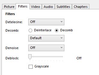

I used VLC to play all the videos.
I have enclosed a snap of my filter settings in Handbrake.
- hb-filter.jpg (10.86 KiB) Viewed 11105 times

I retried my encode (in Handbrake) with the decomb filter turned off and deinterlace (slow) turned on and the resultant file was similar to convertx's output.cedric wrote:I think a video filter can be applied by default in HB, can you check your settings?
So you were correct in saying that a filter is applied.
