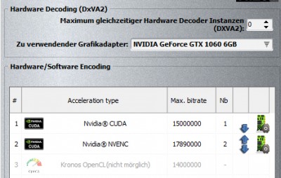

Today i test my new GTX1060 and now CUDA dont work. the nvida gtx1060 has CUDA 6.1.
Is there any chance to make CUDA working ?
I want to set the Bitrate to 30000000.
NVENC works good but the max Bitrate is after testing 17895555.

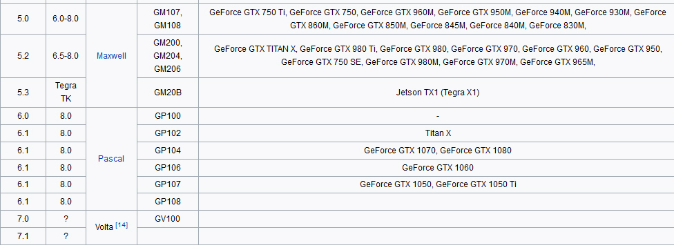

it seems the problem is the "Pascal" Chip on new Cards.
is it possible to change the bitrate in NVENC to 30000000 ?
Please fix this in future updates !

Some of your questions are little beyond my knowledge but hardware encoders do have their own bitrate limitation that you will not have with software encoding.
You might want to make sure the bitrate is not being limited by the target size, you might want to set it to 100gb and see if that changes anything.

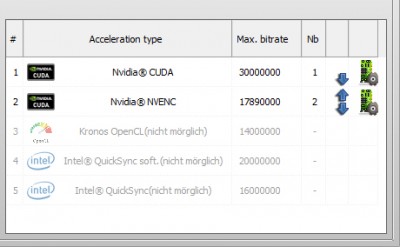

with my old card gtx760 cuda works fine. i set the bitrate to max. and get a fill disk with one film.
now with gtx1060 when i make this i get an error. only nvenc works. cuda dont work with this card.

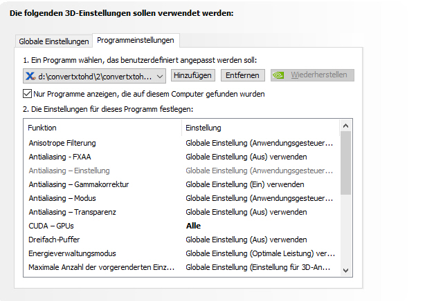

Did you checked your Nvidia driver settings to see if CxtoHD is allowed to use hardware encoders?*

with gtx760 cuda with 30000000bits works fine.

i think some libarys must be updated to make cuda works with new pascal chips.

Can you retry with hardware decoding (DXVA2) disabled?

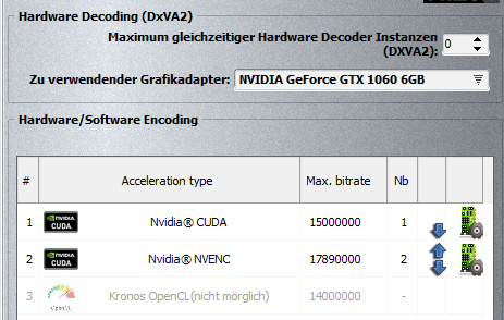

How can I deactivate (DXVA2) ? do you mean with cpu reencoding ? works but only 15fps (3 hours convertion time)

Go in hardware acceleration section (where you choose hardware encoders too), then set decoder instances to 0...
For OpenCL, same section, move opencl encoder line (if available) on top of the list using arrow.

Testing uninstall driver complet with "ddu", uninstall cxtohd then install driver and cxtohd. Still error with cuda option.
why nvenc dont work with 30000000 bits.(in logfile maxrate=30000000) ?

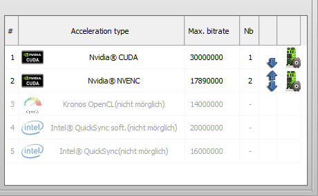

max bitrate with nvenc only 17895697

Cedric was able to connect to your machine (thanks for allowing this).
The recap he gave me was the following:
- he installed the latest CUDA SDK on your machine and tested previous versions and the drivers were still not working
Cedric presumes it is Nvidia blocks the use of CUDA when NVENC is available.
You originally wanted to be able to adjust the bitrate (not having been able to make it as high with NVENC) but you confirmed that when watching the converted result with NVENC the visual quality as very good.
